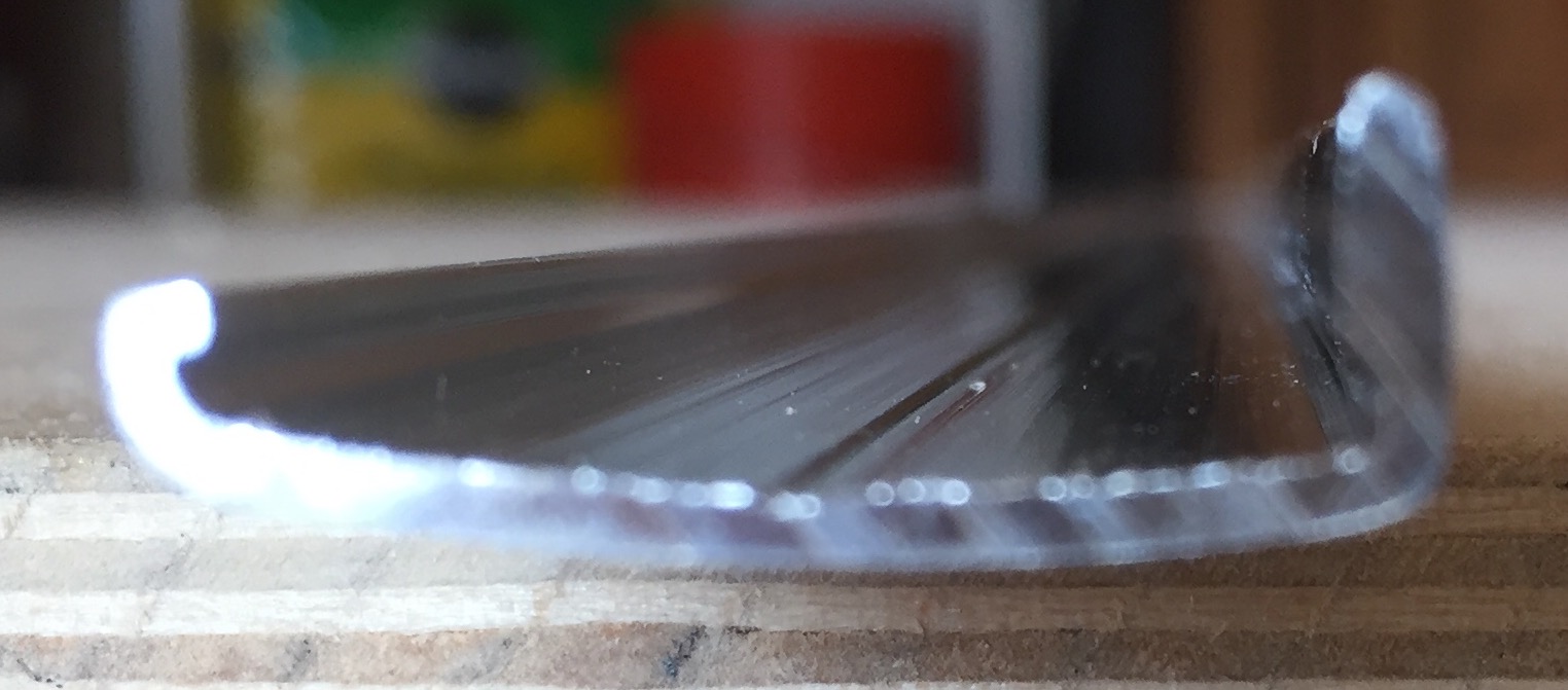

Postby earl84 » Sat Jun 17, 2017 8:04 am
I bought these doors a while ago, and am very close to mounting them. I can't for the life of me figure out what the two straight pieces of aluminum channel are for. The inside frame I understand, the outside drip edge I understand, but what are the two 18"ish straight pieces of aluminum channel used for?

Postby Gunguy05 » Sat Jun 17, 2017 10:07 pm
earl84 wrote:I bought these doors a while ago, and am very close to mounting them. I can't for the life of me figure out what the two straight pieces of aluminum channel are for. The inside frame I understand, the outside drip edge I understand, but what are the two 18"ish straight pieces of aluminum channel used for?
BTW, I have watched your videos on YouTube several times, and they have been invaluable. Thank you so much for doing them.
Hum... I actually just mounted our's today. We didn't have aluminum channel? Can you take a photo an upload it, or send me a link? We have the drip edge and the inside trim, but nothing else. Maybe it was shipping material?

Postby earl84 » Tue Jun 20, 2017 8:21 am
Hers a poor closeup of the aluminum channel. There's two of these pieces for each door. Each pice is 30-1/4" long, and 1-1/4" wide.
I really need some help on resizing and posting photos. I got so frustrated with what a pain it is that I stopped adding stuff to my build journal.

Postby Wildfire » Sun Jun 25, 2017 11:49 am
I just got a door from them (thanks to you for posting the information)
Mine didn't come with the straight channel. Maybe you got some extra bits for some reason?

Postby earl84 » Mon Jun 26, 2017 9:04 am
That's what I'm thinking. Extra pieces not required for anything.
