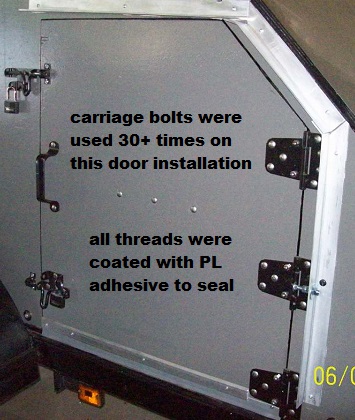

Postby working on it » Wed Jul 26, 2017 7:48 pm
  • I used carriage bolts all over my trailer, they are my primary fasteners, using them to bolt my trailer together, reserving use of screws to the interior only. I used carriage bolts (with either acorn nuts or nylocks) to attach the floor to frame, all wall attachment brackets, all door/hatch handles-locks-hinges...everywhere. I used 1/4"-20 (90% of fasteners used were stainless steel), except for the floor to frame (3/8"-16), and a 1/2"-13 for my spare tire attachment. All holes were thru 3/4" plywood; most holes were drilled prior to saturation with the "mix", during the initial stages of the build, so I carefully coated all threads with the same Loctite PL adhesive I used for all joints, using enough to guarantee no leaks, and I over-coated the exposed heads (exterior) with clear acrylic (UV resistant). Holes drilled later on, thru wood previously saturated with the mix and paint, got the same PL adhesive and acrylic. Underneath the trailer, I also used spray-on automotive undercoating, for extra sealing. By using PL directly on the threads of the bolts, I made sure that the inner grain of the plywood was completely sealed, and all excess spread under the carriage bolt head and under the nut, so as to be completely waterproof.
  • So far, after 4 years, no leaks! But, I still worry about the eight holes drilled in the roof, so I touch up the acrylic over the acorn nuts every year. Another thing, I have had problems when removing the stainless fasteners... they are soft, and break sometimes (I used a 1/4" impact for assembly, probably over-torquing them), so I am replacing them with std. carriage bolts, using the same sealing regimen.
    stainless carriage bolts used for door install.jpg (131.89 KiB) Viewed 9749 times
    carriage bolt heads coated with "mix" & acrylic, threads sealed w/PL adhesive

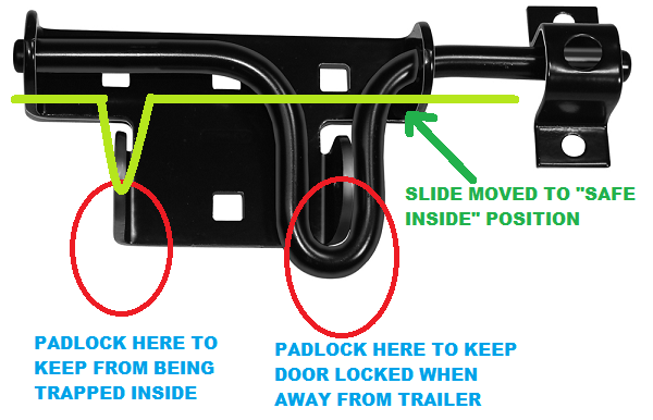

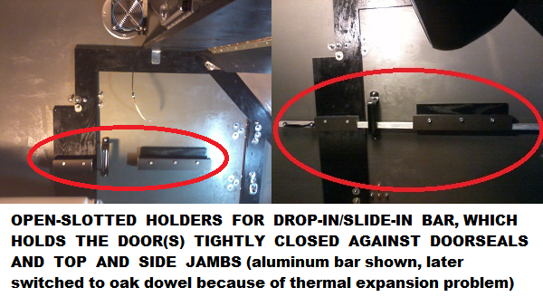

Postby working on it » Fri Jul 28, 2017 5:35 pm
linuxmanxxx wrote:A deviant person could trap you in with a padlock with that setup but a nice looking door.
  • That's why I always padlock them open, with a door bar inside as my interior lock. I have been accused of devious behavior, outrageous behavior (as a younger guy), sometimes just being different for sh*ts and giggles, but (so far) not deviant...but I understand the deviant, malicious, or criminal mindset that would lock me inside. I chose these simple slide-latches because they offered simple prevention against such misconduct.
    Slide bolt latch.png (82.93 KiB) Viewed 9503 times
    each set of slide latches has its' own lock; always secured in one position or another
    inner door locking system.png (264.18 KiB) Viewed 9503 times
    once inside, I pull the door shut, then insert the bar (dowel) and snap it into the slots
