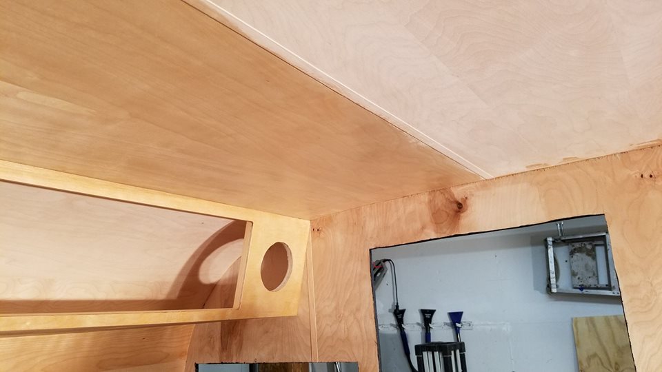

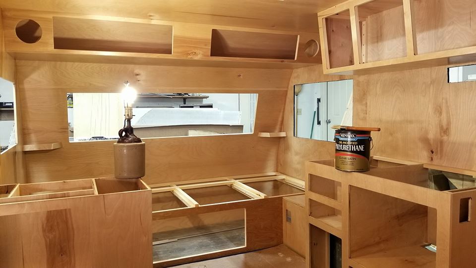

A little late for this project, but next time try the water-based, oil-modified Polyurethane. Quite a bit more expensive, but no odor, a great finish, and water cleanup.

Great pics absolut and I had never heard of Tearjerkers before. Glad I clicked on your link!
