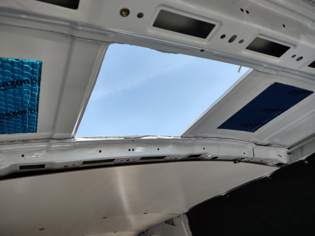

Postby bdosborn » Sun Dec 11, 2022 11:48 am
I got hooked on Fantastic fan before they were bought by Dometic, they had a fantastic warranty. Dometic is just another big corporation so my hunch is it isn't as good as it was. I looked at the Maxxair but put a Fantastic fan in the van because of the voltage problems with Maxxair; the forums I read were littered with control board failures. Ditto on the forward and reverse options, I use that all the time. I have one with a thermostat so it comes on when the van gets hot and then shuts off in the evening. I cut the hole for the vent in April, the fan ran while it was parked at the house all summer with out a hitch. Boy, that was a hard hole to cut. :lol:
