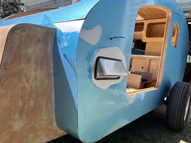

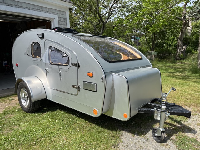

Postby Capebuild » Mon May 29, 2023 8:40 am
I installed side vents and find them very effective when used in conjunction with the fan. They allow a ton of air to be pulled in and circulate through the the trailer. I also have windows that open which also allow air intake. We don't necessarily leave the vents open when on the road but I suppose we could. I placed bug screen on the inside of the vents to prevent gnat sized bugs from being pulled in.
John
