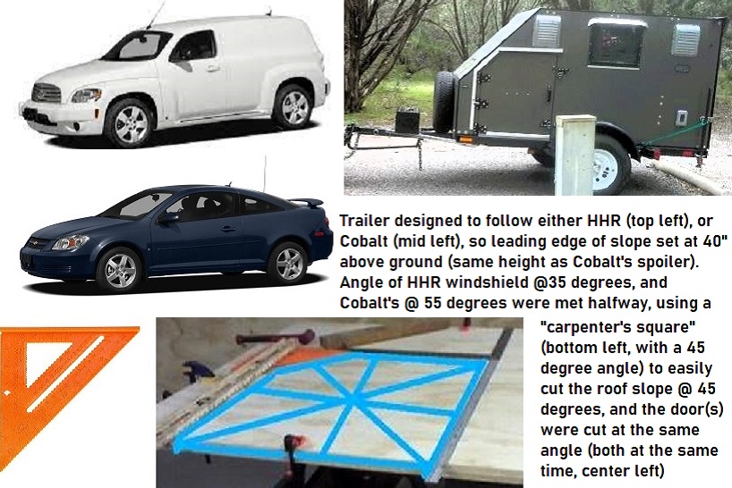

Mine's not a foamy, but it is a squareback "box", so I was trying to mitigate air "drag" when building my 4x8. It was supposed to end up under 1000 lbs, but wasn't even close, made of 3/4" plywood with lotsa steel inner bracing/hines & latch hardware/bolts etc; but I tried to fit it within the wind shadow of my wife's '08 Chevy Cobalt (it was going to be her trailer, but I took it over) or of my '09 Chevy HHR Panel, both with a towing capacity of 1000 lbs.
I wanted the front of the trailer to have a sloped roofline, to match the side profile(s) of those vehicles, but they were different, at approximately 35 degrees for the HHR an 55 for the Cobalt. I compromised at 45 degrees, which made cutting the plywood side profiles & doors much easier, and determined that the height of the leading edge of the front slope should match the height of the Cobalt's rear wing, 40" (or 42", I forget) off the ground. That fit nicely with the floor height of 24", which left 16-18" for footroom below the angled front slope (in this trailer, you sleep feet forward the nose). Just for reference: the drag coefficient for the Cobalt is .32, and the HHR is .354, which we'll come back to, later.
Trailer designed to follow either HHR or Cobalt, 45 degree angle slope a compromise.jpg
Trailer designed to follow either HHR or Cobalt, 45 degree angle slope a compromise.jpg (190.66 KiB) Viewed 3655 times
