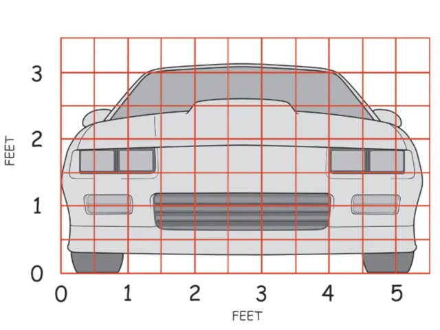

The first measurement we'll often talk about is called frontal area, A - this is the two-dimensional size of the "hole" that gets punched in the air when you are moving forward. We'll usually express this size in square feet, or square meters in metric. teardrops usually excel in this measurement, because they are small when viewed from the front.
The area of the grid that is filled in by the outline of the car is the frontal area.

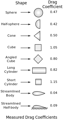

The next measurement we'll often use is called the drag coefficient, Cd - this is a dimensionless number (there are no units like feet or inches) that describes how the shape of your vehicle affects how easily it passes through the air, compared to other shapes. The smaller this coefficient, the easier that shape moves through the air.
Our ideal for a ground vehicle would be to get as close to the streamlined half-body figure as practical.

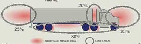

Let's first take a look at an illustrated breakdown of where the largest drag features are located on a compound vehicle (tow vehicle+trailer). This will guide our efforts towards the highest reward areas we could focus on:
That diagram gives us the well understood fractions of what each part of the vehicle contributes to drag - 25% for the front, 30% for the wheels and undercarriage area, 20% for the break/space between the two vehicles, and 25% at the rear. Let's assume the front of the tow vehicle is a fixed or unchangeable variable and we design the trailer to fit perfectly behind it (not sticking out in any dimension, taller or wider.) The breakdown then for the focus of the trailer designer is 27% for the space between the trailer and the tow vehicle, 40% for the undercarriage and wheels, and 33% for the rear of the trailer. The overall size or frontal area is something also well within our control, and we can always work to fit more into a smaller package. A perfect example of this is the popup standie designs, you have nearly double the interior volume, but it moves down the road at roughly half its "camping size!"
Undercarriage and Wheels - 40%

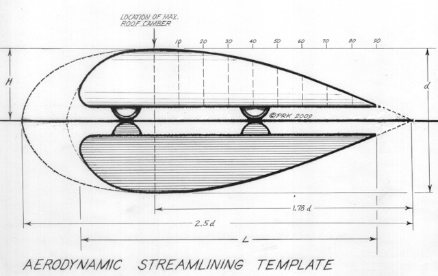

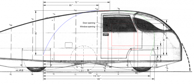

The first, side view:
To use this template, you just overlay your trailer design on top of this drawing. You must follow a few simple rules to line everything up correctly.
  • The bottom of the trailer tire needs to be on the flat line at the bottom
  • The tallest point of the roof needs to line up with the tallest part of the template, where the 0 degree mark is indicated. Slide the template left or right so that the 0 mark is lined up perfectly with the peak of your roof line - for this part, it doesn't matter if the front lines up with your trailer at all.
  • Do not scale the drawing in such a way that it is stretched out or squished in any way - the aspect ratio must not change. You can resize the drawings so they fit up in height, but the ratio of height to length of the template needs to stay constant to work properly.

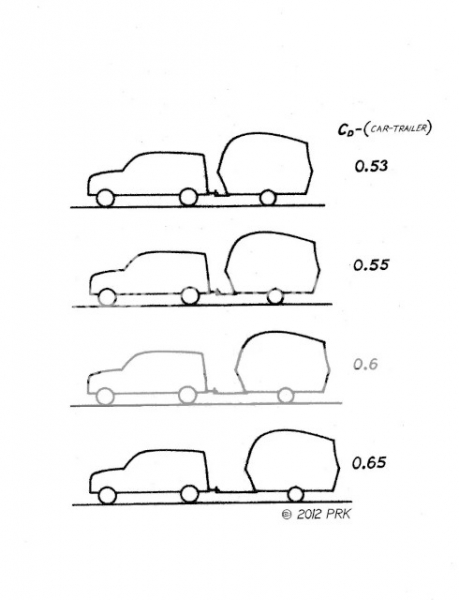

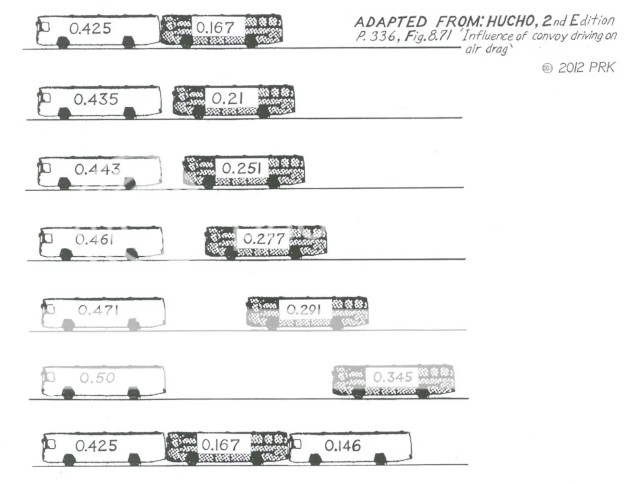

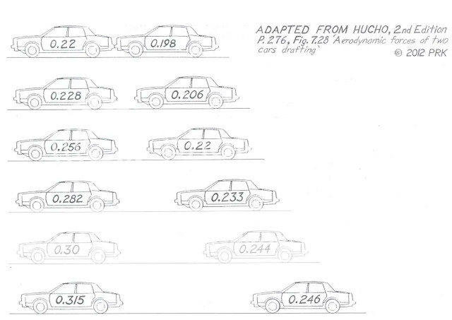

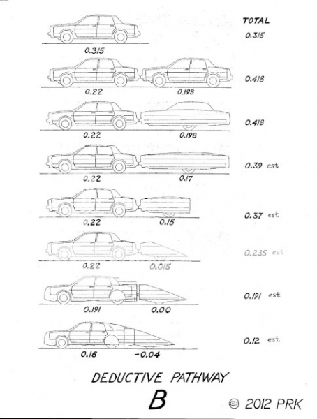

Tow vehicle to Trailer Gap - 27%
It would be nice if a trailer, that is the same size or smaller than the tow vehicle, would just slide into the air pocket behind the tow vehicle and experience no drag at its front end. Unfortunately, this is not the case. This space is something you should really focus on, especially if you have to give up optimizing on other parts of your design due to the shape, space, or features you want on your build. The ideal here is to have no space between the vehicles, with no gaps for air - this would be like driving around one of those articulating bendy busses that have a smooth accordion-type joint in the middle. That kind of solution will most likely be impractical for your build. The next best thing we can do is fill in that gap as much as possible, and make the front of our trailer as easy as possible for the air flow to reattach smoothly. I've included some illustrated examples of the effect this gap has on compound vehicles that were done by Phil Knox.
You can see that you might approach the gap filling in a variety of ways, but consideration to turning and the articulation angles must be taken with care. You can close the gap with the trailer shape, vehicle fairings, or a combination of the two. Semi truck trailers often use a combination approach to close the gap. The Camp-Inn 560 "raindrop" shape probably offers some advantages to note here, due to being able to have the leading edge of the trailer physically closer to the rear of the tow vehicle, as well as providing a fairly smooth path for the air to reattach along the sides of the camper body.
Take note of the final illustration "Deductive Pathway B." This demonstrates that you could in fact use a trailer to lower the total, combined drag coefficient below that of the tow vehicle alone with a well designed pairing, making the combination more efficient than the tow car alone.

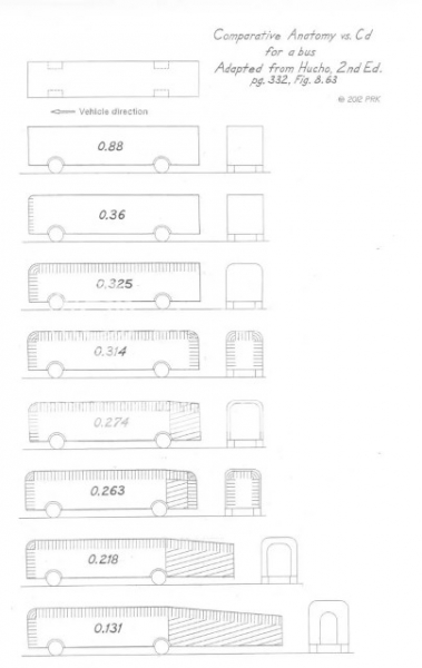

The effect of radius corners and adding a boat tail on a bus profile.

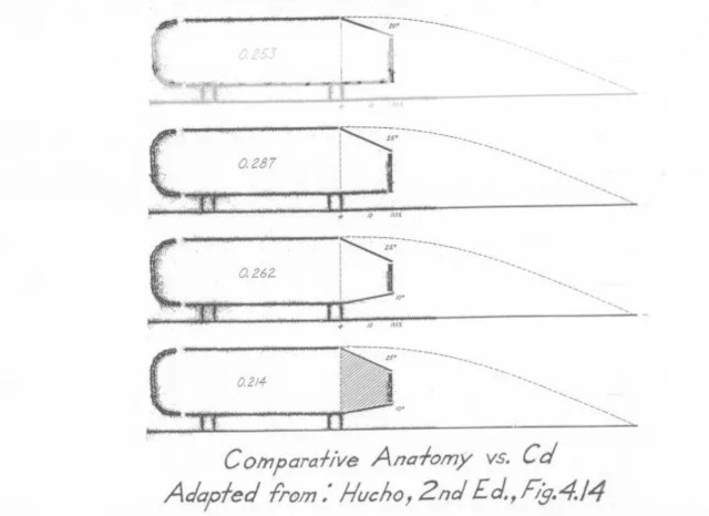

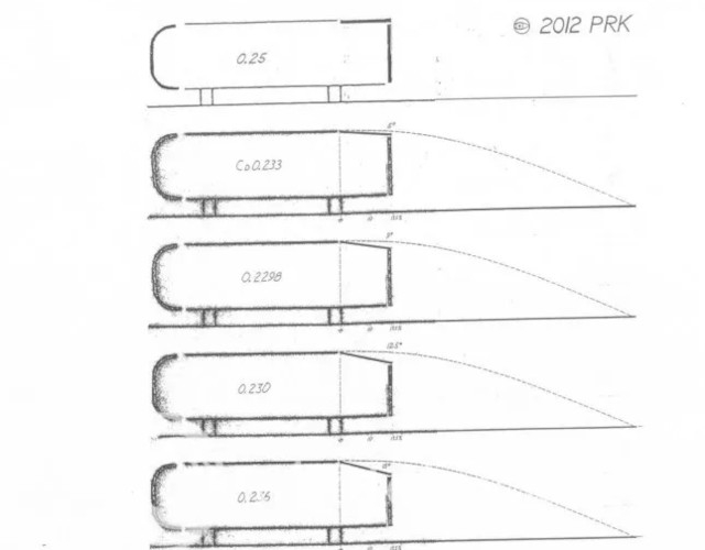

The change in drag coefficient of various "kammback angles" - demonstrating you can make things better, or worse, with taper.

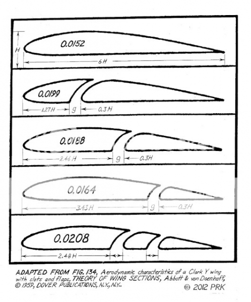

Fineness
Fineness, or fineness ratio, a term in fluid dynamics or aerospace engineering that describes the ratio of the maximum width of a fuselage relative to its length. For our sake, we want to make a kind of "smooth egg" that fits within our ideal streamline shape, and avoid things like sharp corners, edges and abrupt transition points. Radius corners are an example of improving the "fineness" of a body design. If we place something simple like a 3" radius along our entire top edge perimeter between the side walls and the roof, we can drastically decrease the formation of turbulence and drag vortexes that can spawn off that sharp edge. This is especially true in cross wind conditions, where the side of our camper effectively becomes the "frontal area" for some portion of the airflow over the body. Modifications like these can be very important and exhibit a large difference in total drag between two otherwise identical shape profiles.

I can't read the angles on the Kammback drawings. What is the angle at which the Kammback is worse than a square back? Would that not imply that for the typical tear drop shape there is point where it would be better to just square it off?

Pmullen503 wrote:I can't read the angles on the Kammback drawings. What is the angle at which the Kammback is worse than a square back? Would that not imply that for the typical tear drop shape there is point where it would be better to just square it off?
I've split the original into two images to get a little more resolution into the gallery and reposted them. The angles are almost illegible in the original file, but the Cd is at a minimum/best at 12.5 degrees down slope, begins to increase at the next image (15 degrees) and the drag coefficient is worse than the baseline non-sloped roof at 20 degrees down slope. The last image in the set shows the steepest down slope of 25 degrees, with a 10 degree upsweep angle at the bottom, the shading indicates a side taper, but the angle of the sides is not called out in the text. The addition of the side angles into the mix achieved the lowest total Cd, even with the non-optimum/too steep roof slope angle of 25 degrees.
If I remember correctly, the Toyota Prius roof line is somewhere between 10 and 12.5 degrees slope angle as well. The design streamlining template has angles marked on it at the dotted lines, that may be illegible in this small format from the gallery. The crown of the roof is marked at 0 degrees, and the marked stations in order along the gradual slope at each dotted line are 3.5 deg., 7.5 deg., 12 deg., 15 deg., 18.5 deg., 21 deg., 22 deg., 22 deg. The slope approaches that steeper incline very slowly, of course.

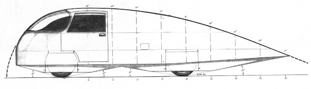

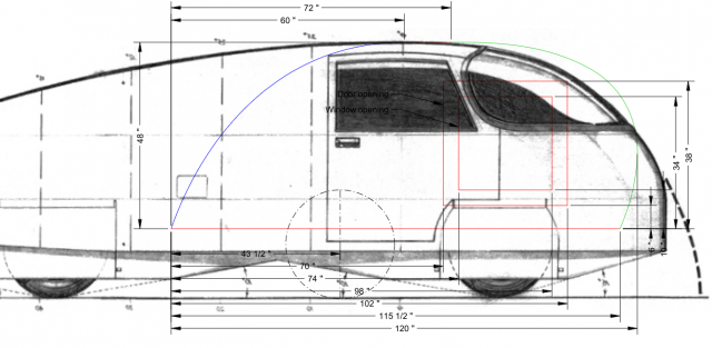

Here is a correct example of using the streamline template overlay on top of the traditional profile 'Trailer For Two" using the online Ecomodder tool linked above - the 0 degree mark is placed exactly where the roof slope/hatch starts, 60 inches from the rear of the trailer. The trailer wheel in the design is lined up with the line at the bottom of the template. We ignore everything ahead of this towards the front, we're only working on the rear slope. The blue line is the original hatch profile. To improve the aerodynamics, we would remake the trailer with a gentle roof slope curve matching the roof line of the template, and draw a straight line from the bottom of the trailer to the new roofline, a flat vertical rear hatch. In this case, there is not much roof curvature at all in the rear - this is normal. Experimentally we could *slightly* increase the slope of this curve, test, and rework the design. In all likelihood, the maximum angle that could be achieved would likely be less than 15 degrees while keeping drag minimized.
Alternatively, because the ideal roof slope for aerodynamic purposes tends to be so shallow, we can move the starting point of the curvature forward. In this way we can get the area at the rear of the trailer smaller, the wake zone, without really losing much headroom inside. Here's an example with the start of the curve moved forwards, above the door:
In basically all cases, you start to end up with hatches and roof lines that look a lot more like the rear end of a Prius shape, than a traditional teardrop!

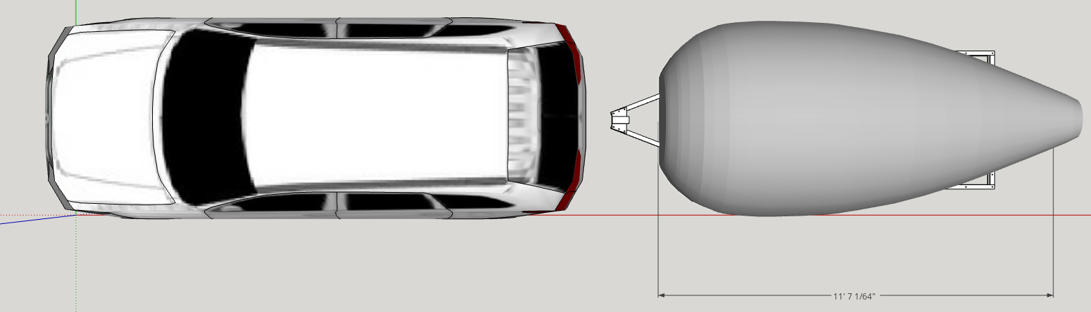

Postby kd8cgo » Mon Feb 05, 2024 1:19 pm

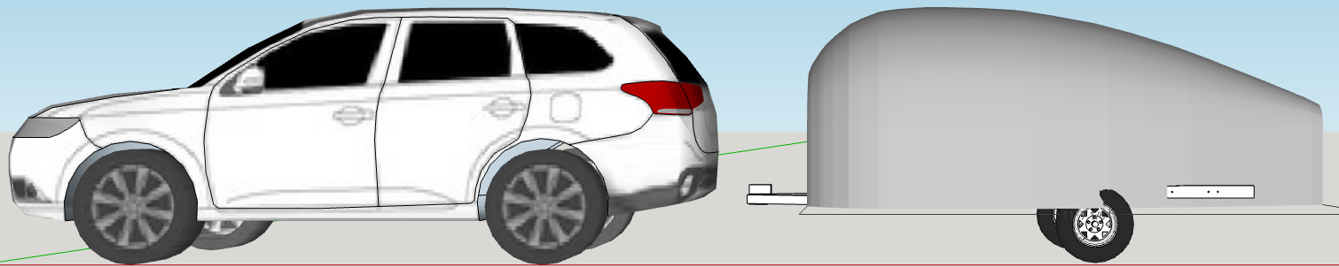

Sketchup 3D examples of an approximate "fully streamlined half-body" on top of a Harbor Freight 4x8 trailer, behind a basic model of my tow vehicle. This is not intended to showcase an actual build design, but simply what applying the streamlining template in 3 dimensions (with no other shape constraints or considerations) would look like. I scaled the body shape to the width and roof height of the tow vehicle, it ends up 5 1/2 ft. wide, and ~4' tall above the trailer deck at the roof peak. The body length in this example, coming to almost a point at the rear - is just over 11 1/2 ft. long. I thought this might help visualize what the curvature of a streamline looks like next to "real components" like the car and the trailer frame.
Driver Side.png (157.27 KiB) Viewed 4167 times
Plan View.png (155.71 KiB) Viewed 4167 times
Driverside Rear View.png (161.92 KiB) Viewed 4167 times

Postby Pmullen503 » Mon Feb 05, 2024 4:58 pm
That drawing is very helpful. I have designed something similar: make yours 6' wide, squash the height to 3 feet above the trailer and chop a couple feet off the end.
How much would chopping off the streamlined end to get a wider galley impact drag do you think?
The trouble with a design like that is you have to build it more like a boat. Cedar strip, "tortured plywood" or a fabric covered frame ala aircraft or skin kayak. On my design, I was going to make the roof lift to give it more head room but unless I go soft sides like a pop-up it becomes really difficult to build.
That's the problem. The traditional design is well within the abilities of the average builder. And is it worth dramatically increasing the build difficulty (and expense probably) for the fuel savings?

The answer is always, it depends. If you look at the model of the SUV, they applied all the same streamlining techniques you'd apply to a teardrop trailer, if you look close. The rear end is boat tailed just aft of the peak of the rear fenders, the roofline follows the appropriate streamline aft of the peak camber at the b pillars, the roof and roof rack rails in the plan view are narrowed relative to the width at the beltine, tapering the sides inward on the Z axis. Streamlining is a incremental process. The more you do it, the more the design will begin to resemble that geometric half body. Many of the design modifications, like using the appropriate roofline taper/curvature, add zero difficulty to a teardrop build, it's merely correcting the existing geometry using the same building technique in that case. You can go as wild, or mild, as you please.
Keep in mind, the body shape work only accounts for 33% of the total aerodynamic optimization. It's probably the hardest 33% to fully capture. The undercarriage and wheels are far more important at ~40%, and easier to fix as well. Same with the trailer gap, no body redesign work necessary and worth 27% of the total potential gains.

Pmullen503 wrote:How much would chopping off the streamlined end to get a wider galley impact drag do you think?
For this, the closest speculative resource I think I have available is the "bus diagram" with the boat tails and radius work - the full and gigantic boat tail cuts the drag in half relative to the short boat tails, but the short boat tail recovers an impressive amount of Cd all on its own. Relatively small additions of taper (and radius) seem to have a pretty amazing impact relative to square edges and non-tapered rear designs.

"The undercarriage and wheels are far more important at ~40%, and easier to fix as well."
I've thought of that as well with an almost free material: coroplast political signs. They are pretty much free for the asking after an election (especially losing candidates). I plan to attach them to the frame with plastic rivets. The bigger signs are 3x6 ft.

Take a look at what one company that is focusing on aerodynamics is doing - Polydrops. Their page on aerodynamics makes it easy to understand why a well-designed "boxy" camper can massively outperform traditional designs in this respect.
Incredibly, 5x more aerodynamic than a standard teardrop!
