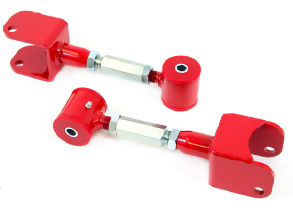

SilverJKU wrote:It's been far too long since I posted any updates so here's a few. I decided to try my hand at building my own multi-axis coupler seeing that I just plain don't have the $325CDN to buy a MaxCoupler right now. I started with some old control arms I had laying around and used those for the vertical and horizontal pivots for the hitch. Poly bushings provide too soft on the vertical end so I had my younger brother machine me up a solid aluminum bushing and used some UHMW plastic I had leftover from a skid plate and made a top and bottom washer for things to pivot on. The aluminum bushings works perfectly and keeps the bolt straight up and down instead of moving 20* of so that the poly bushing did. The rotational point is comprised of a 1" bolt that pivots at one end and welded to the other. Took it out for a little test and seems to work fine but no pics of it in action as of yet.
  • I'm also arriving late to your build. Nice work! Your MaxCoupler clone/substitute looks really well done.Do you have measurements, and perhaps more photos to share, as I have two unused brand new adjustable control arms, just sitting in the trunk of my Chevelle (along with new springs I never installed, when I abruptly quit racing), and I might want to try my hand at making my own coupler.
    control arms.PNG (170.22 KiB) Viewed 6934 times
    UMI adjustable upper control arms ('68-'72) for my Chevelle (with a '68 12-bolt axle, 4.88 gears)
  • I would have to make some mods to the arm, of course, but perhaps it would be do-able, and cheap, since I already have the basic parts on hand (I think I have some UHMW bushings, which I made for my ladder bars. Lots of parts, and a race-car just sitting, what a waste...might as well re-purpose.
