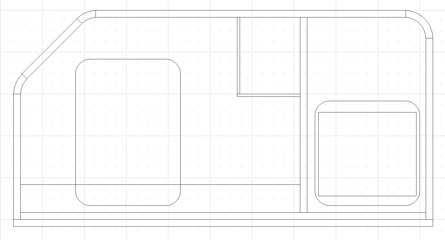

Thanks for any comments or advice. Below is my current incarnation of the build. Its 5' wide and 10' long

The curve on the rear of your drawing looks a bit tight for bending 1/8" Baltic to me.
But that's my six-bits. :thinking:
