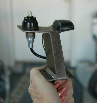

I used steel tubing for my fender mounts, tail light mounts, and antenna mount.
