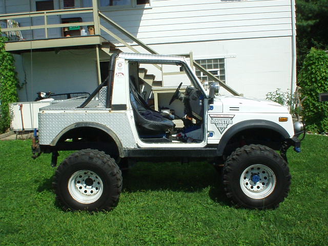

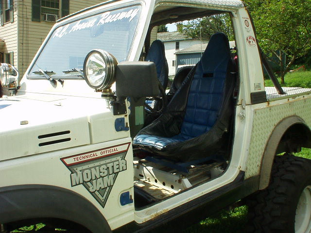

I spent last winter rebuilding my TV and most of this summer testing and refineing the mods. Here it is.

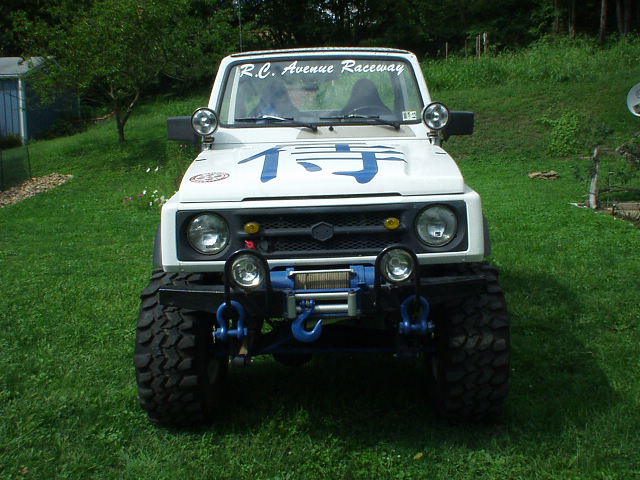

Image93 Suzuki Samurai.
ImageI went from 31" swampers
Imageto 33's with a spring over lift.

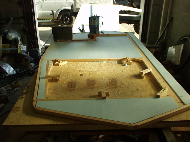

ImageI liked the topic about the foam trailers just covered with cloth and paint.
ImageStarted with 1' foam. Just enough wood for support where needed.
ImageI need more on the outside to deal with the trees and rocks so I covered the outside with 1/4 lauan.
ImageSides up. I have a bit more done, galley framed out and most of the roof but no pics yet. After the "box" is done I'll start on the frame

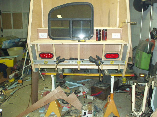

Postby TOTAL CARNAGE » Sat Sep 03, 2011 6:40 pm
Once again, Thank you all. I went back and looked over the Sawtooth build. I was not trying to copy that build but they are very much alike!

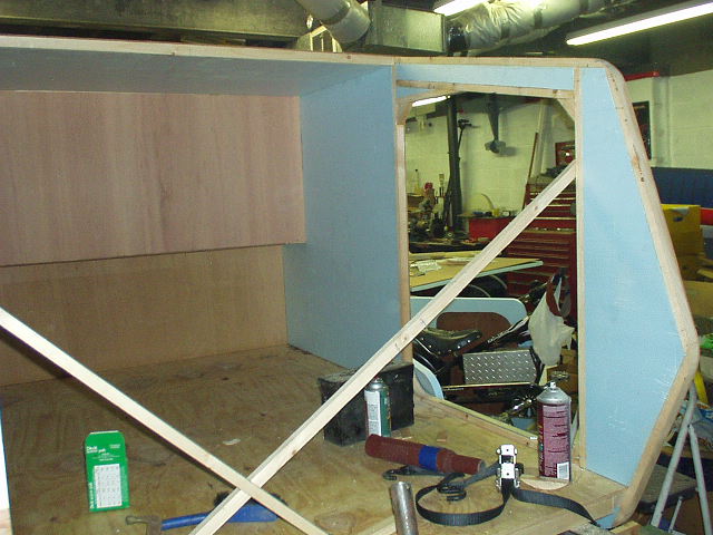

It's hard for me to keep up with the pics but have a few more for you.
Here is the galley area framed in. I will not have a outside door to the lower storage but the counter top will lift up. This is where the battery and electrical stuff will be so I don't need in there often.
Everything will be 12v. LED. I am going to have two 120v. outlets in the galley, one inside and one for the battery tender for the rare times when I have a place to plug in.
Cabin area. I still haven't decided how to finish the inside and know it will be harder to do with all the walls up but......
The X brace is just keeping things square untill the roof and front are on.

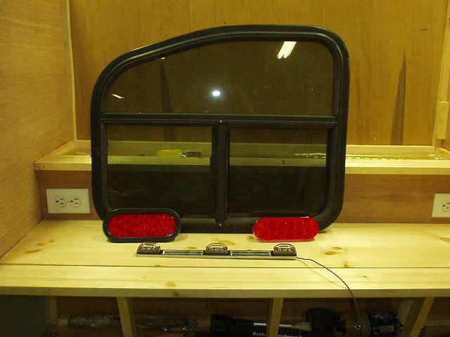

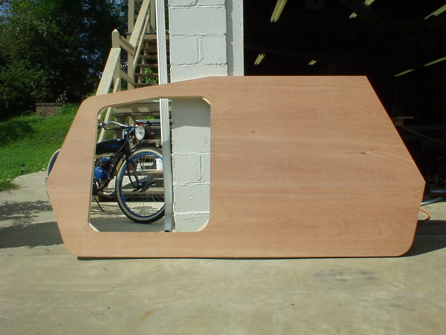

I picked up a few lights Friday. LED tail and marker lights. I got my door windows out of the sleeper of a trailer truck we were junking. I had been wondering just how I was going to build the windows when I looked up and saw these. I can't believe how perfect they are!! They fit the shape of the door like they were custom made. The bottom glass is a slider with a screen inside.

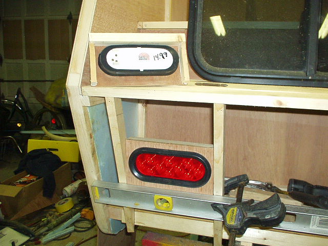

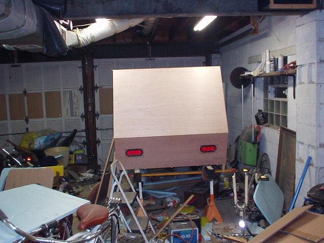

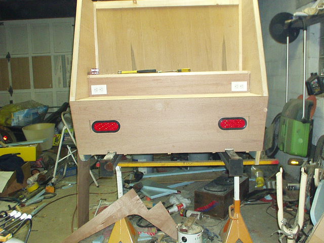

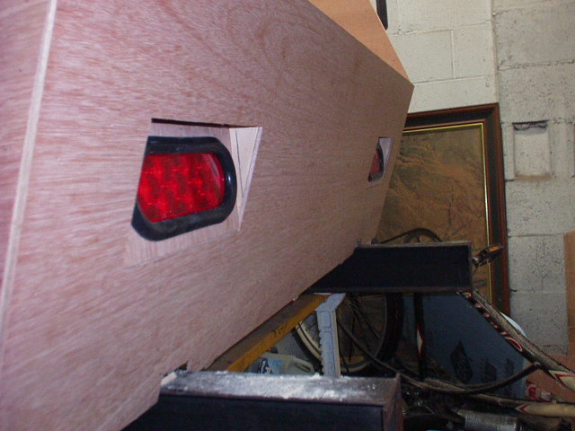

Postby TOTAL CARNAGE » Sun Sep 04, 2011 12:07 am
Built the mounts for the tail lights.
Rear panel and lights installed

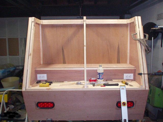

Postby TOTAL CARNAGE » Wed Sep 07, 2011 8:44 pm

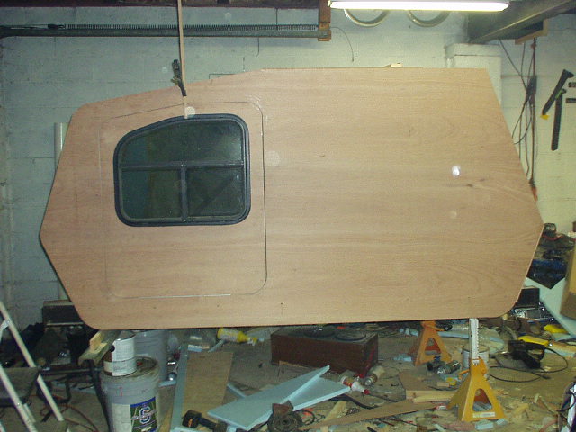

Well, not much to report but I did get the battery box built, frame for the hatch is done and I finished a door. That by far has been the hardest part of this build. Trying to get a perfect stright and consistant gap was rough but I have it where I'm happy

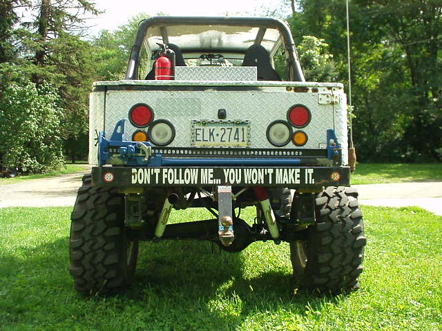

Postby Woodstramp » Thu Sep 08, 2011 1:58 pm
TC,
Cool truck. Love the sign on back..."Don't follow me...you won't make it." That's funny right there. :lol:
You camper is looking great. Looks like you are on the ball.

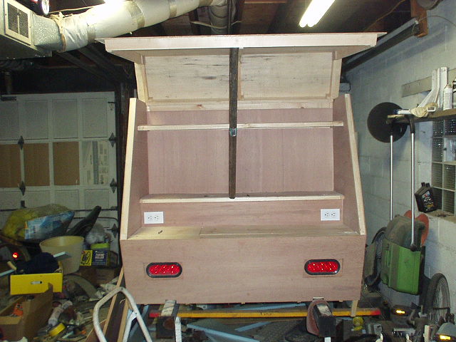

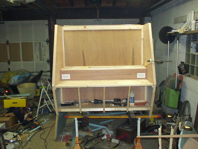

Postby TOTAL CARNAGE » Mon Sep 12, 2011 11:32 pm
sorry I haven't up-dated in a while. I have been working on the camper every night but it's been little nit-picky stuff not worth pics or typing.....
I have got the rear figured out. One more shelf, face and doors and the cabnets will be done. Think I'm going with sliding doors back here. Still need to wire the hatch for lights and skin the inside.
It was at this point when I realized I didn't make a pocket for the plate...oh well, I'll figure some thing out.
