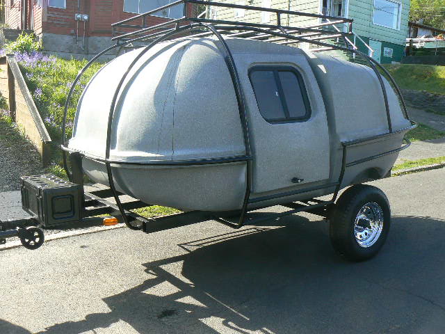

Just get lucky and find a tear drop american trailer . as we used to build ower off road TD. Pics in my profile .We are now adding the trailing arm suspension and air bags I will post pics of the finished trailer nexed week.
This trailer is all abs plastic and with all the pollyfoam we blew into it during the build it floats rather well. I designed it with water crosings in mind.....Boxcar

Postby boxcar » Thu Apr 22, 2010 11:21 am
Here is my anser to water crosing

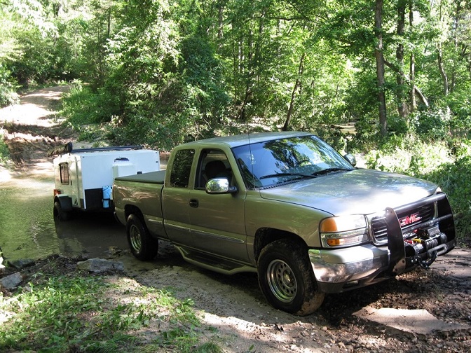

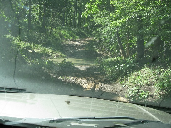

water crossings should be taken seriously, the approach & the exiting, I never cross fast or deep water. When I was researching small squaredrop trailer manufactures (looking for a candidate to do a offroad squaredrop build) I liked how Runaway has a rubber membrane underneath the floor, the cabin (under construction on video) all the corners are wrapped before the adhesive & aluminum siding is attached. Runaway's method of attachment of the cabin to the chassis is also very impressive making it for good waterproof system.
When I done all the modifications & fabrication work to our 2019 Range Runner, ground clearance of chassis was 24", axle clearance was 14". Sally & I make numerous creek crossings on our backcountry adventures in the Ozarks. We never had any water inside the cabin or rear storage area nor leaking from the inside of the chassis. I periodically check the chassis for rust, rear storage area for water staining. I store the trailer inside a large shop building on my farm.
I used automotive sealant between the aluminum siding lower edge & bottom edge were the cabin & chassis meets (Black). When I re-placed the tail lights & re-wired the trailer lights, attaching the wires (fasteners) to the underneath floor to the membrane & chassis I sealed these areas extremely well with sealant. All accessories attached to the outside of the squaredrop 2 1\2gal Roto Fuel Pax, 2 1\2 gal Roto Water Pax, Hi Lift Jack Mount I made rubber gaskets & using sealant (Big Stretch) with large fender washers & locking nuts. Water will find a way into areas you do not want it to go. So far I've been lucky or successful not having any water leaking into areas of the trailer. Maintenance is a must, checking on the sealant applied, water can & will ruin a wood structured trailers.
