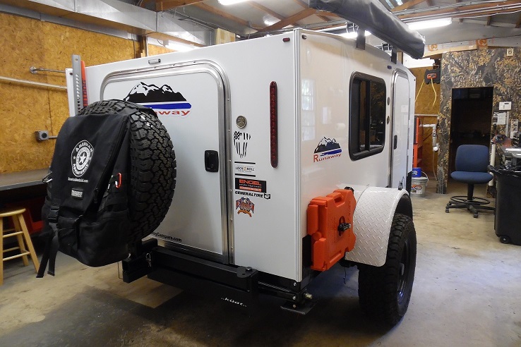

Postby ArkansasDon » Wed Feb 05, 2020 5:19 am
I installed the 28" Bal C Series 4000lb jacks with the pads. I run 30" General Grabber ATX's on my trailer w\ 24 inches of chassis ground clearance.
