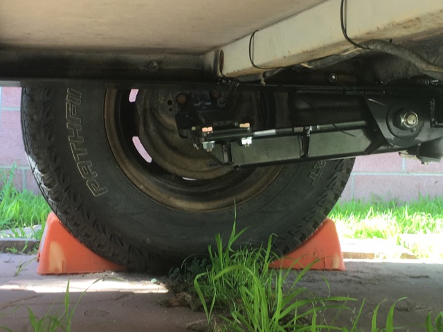

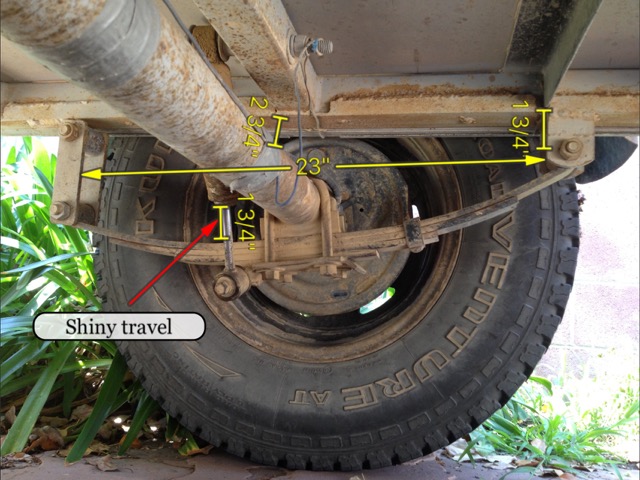

Here are 3 photos all showing pretty much the same view; the inside of the drivers side trailer wheel. The important differences are that the first photo is with leaf springs, then second with the Timbren axle-less suspension with Straight spindle, and the 3rd photo is the same Timbren except with the 4" lift spindle.
Leaf Springs & straight axle
Leaf straight axle IMG_7994.jpg (109.43 KiB) Viewed 11318 times
Timbren Axle-less with straight spindle
Timbren straight spindle IMG_9217.jpg (81.01 KiB) Viewed 11318 times
Timbren Axle-less with 4" lift spindle
Timbren 4Lift spindle IMG_9342.jpg (74.88 KiB) Viewed 11318 times
Last edited by Dave Nathanson on Fri Mar 10, 2017 7:22 pm, edited 1 time in total.

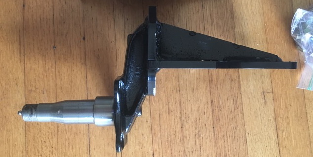

Here are photos of the Timbren straight spindle and the Timbren 4" lift spindle. Both are the heavy duty 3500# models. Both of these are right-side-up. They bolt onto the top of the suspension arm. So the flat side of the spindle mount does face down. I will mention that I'm impressed with the sturdy construction of the Timbren suspension.
Timbren Straight spindle
Timbren straight spindle IMG_8117.jpg (134.63 KiB) Viewed 11317 times
Timbren 4 inch lift spindle
Timbren 4Lift spindle IMG_9215.jpg (79.95 KiB) Viewed 11317 times

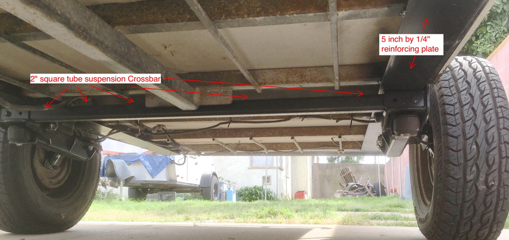

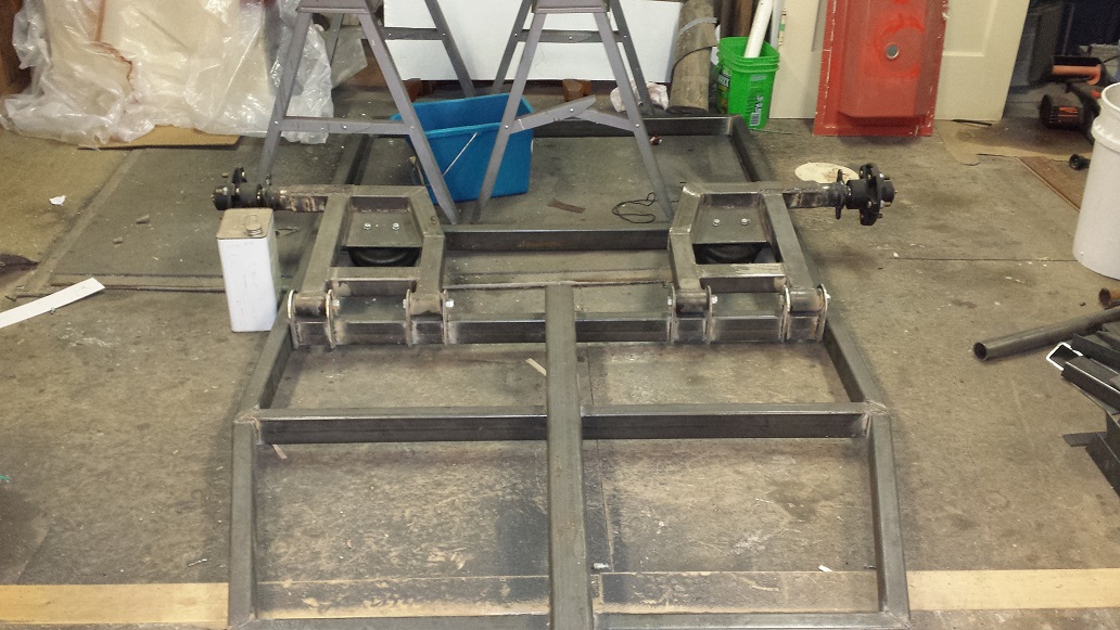

More Timbren details... Yes, there is a crossbar to connect & strengthen the two side suspension pieces. Timbren says this bar is optional, but I definitely wanted it. It is a 2" square tube, bolted in at each end.
Before installing the Timbren suspension we welded on a 5 inch by 1/4 inch plate from tip to tip along each side. That might be overkill for most people, but I've torn this frame before, so I knew some reinforcement would be very helpful. Actually we had to remove some of the previous angle iron reinforcement so we could add this reinforcing plate. The secured reinforcing plate also makes it less likely that the suspension can twist in or out.
Timbren crossbar & plate IMG_9341.jpg (186.11 KiB) Viewed 11310 times
Here is the end of that crossbar (driver's side). Timbren recommends bolting and welding it in, but that would make it very difficult to repair on the trail... As you can see, when my TD is connected to the Jeep, the lower edge of the trim is about 20" high just forward of the wheel. (ok, it is 19 7/8) Slightly lower in back, at 18.75".
Timbren crossbar end-measuring IMG_9336.jpg (53.41 KiB) Viewed 11301 times

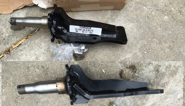

For those who may still be wondering about the difference between the Timbren straight spindle & the 4" lift spindle, here are two photos. Same trailer, same driver's side trailer wheel, same suspension, but different spindle.
Timbren straight spindle from rear IMG_9254.jpg (77.03 KiB) Viewed 11282 times
Timbren 4 lift spindle from rear IMG_9346.jpg (90.49 KiB) Viewed 11282 times

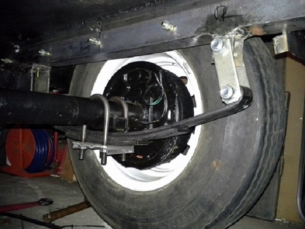

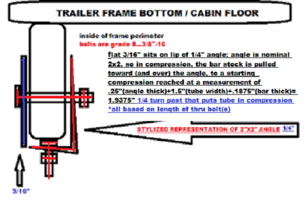

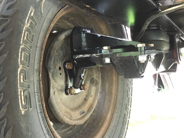

I've torn my frame, too, ripping a hanger off the frame. Because of that, when I was going to fix it, I added a 2"x2"x 36" long, 1/4" thick angle (with spring hangers welded - and bolted) to the frame, and a corresponding length of 2" tall 3/16" thick steel to form a "sandwich" around the original frame. It has stood up to an airborne trip over a massive pothole at 75 mph, without any ill effects. I'm sure that the reinforcement resisted a landing force that would've torn/bent my un-reinforced original frame. Not overkill, but thinking ahead.
torquing of hanger assembly (theory).png (129.98 KiB) Viewed 11250 times
frame reinforcement & spring hanger assembly installed.jpg (93.55 KiB) Viewed 11250 times

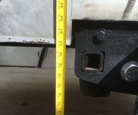

Postby drewh1 » Wed Dec 20, 2017 6:24 pm

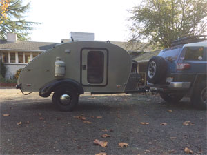

well it is not a great photo but this is it - 18" of ground clearance, I had to turn over the trailer hitch to raise it up and replace my wheel/jack as it was no longer long enough. So even with the 14" wheels and tires, I still have more clearance than the FJ.
I only drove it around the neighborhood but noticed it felt very solid and did not rattle over bumps at all. Can't wait to try it off-road this spring in Oregon.

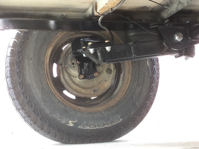

Leads me to my final system trailing arm airbags. The tear I am building now is the third I have done this way. I design the trailer so as to have nothing under body at all the trailing arms are it.
on airbags at full rise I have 22 inches of clearance on 31 inch tires. I can adjust this from 18 to 22. the system works well the trailer hardly bounces on washboard roads and stays solid in off-camber situations. I have an onboard air compressor to keep bags inflated. I air up and down for parking and road conditions. highway hard off-road a little softer and when parking I drop to bump stops for steadying.
trying to remember how to add photos will add later.

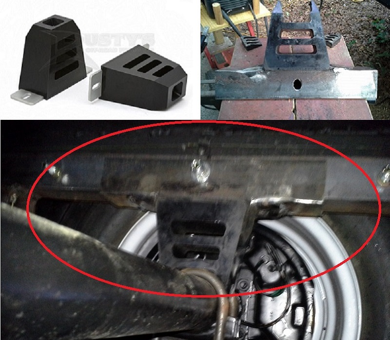

  • I don't agree that a leaf spring axle is too "bouncy" to ride right, and that only Timbren axles, or torsion axles are the way to go. I like, trust, and have easily repaired leaf spring axles, before, and wouldn't write them off to history, as being out-dated or incapable for light or heavy use. with a little planning or modifications, you can tailor leaf springs for any road condition.
  • As I stated before, earlier in this thread and in others, I stayed with leaves on my last trailer mod/upgrade, when replacing my original axle and springs (overloaded spindly axle of unknown capacity) with a Dexter 3500 lb axle w/brakes. I replaced the original equipment with off-the-shelf springs from Northern Tool. I bought the 3000 lb (a pair, sold individually) springs, because I knew I was loading my trailer heavier with each trip, and modification, and was pretty sure it would weigh more than 2000 lbs eventually. I would've preferred a 2500 lb rating, but they didn't offer a rating in between 2-3k lbs in the size/type I was using, I got the 3000 lb set which has worked pretty well, so far.
    northern trailer springs asst..JPG (128.95 KiB) Viewed 10018 times
  • Since my previous spring set had a shackle tear loose from the frame. I reinforced the frame rails with 1/4" angle, boxing in/ covering over the trailer frame, I opted for all new hardware. New leaf springs and all the associated hardware are easy to come by in North Texas, and I chose to stay with leaf springs due to ready availability everywhere, and standardization of the hardware making repairs easy to do. I previously had another trailer spring problem, on my tandem trailer, which I had grossly over-loaded with engine blocks and heads, breaking one spring when it over-flexed (used a ratchet strap, 5000 lb rating, to secure the broken end). I replaced it in a parking lot near the Redneck Trailer Supply that I passed on my way home, where I got a replacement spring. Later on, I replaced much more hardware, worn and rusted out, on that trailer in 2007, when I replaced both axles with new Rockwell-American axles (each 3500 lb w/brakes), at a friend's shop near Azle, where there is another ready source for spring axle parts.
  • I added an oversized, progressive, bumpstop (modified to fit between axle and frame, with no gap), to serve as a means to soften hard jolts, and prevent the springs from over-flexing (which tore loose the shackle on my TTT, and broke the spring on my tandem trailer). I tried it as an experiment, in lieu of using shock absorbers, or air bags, or Timbren airless springs. Since I made my own "active airless suspension", I see that Timbren makes their own version, which wasn't made back in 2014, when I made mine.
    Timbren active bumpstops, active suspension.png (504.13 KiB) Viewed 10018 times
    vs homemade, earlier version
    my active suspension modification.jpg (183.36 KiB) Viewed 10018 times
  • It works very well, proving itself when it protected my springs from breakage, when my trailer flew after hitting a major pothole at 75 mph (so bad that it caused belt separation in three of my truck tires, 10 ply, on my Chevy 2500 HD). I haven't taken it off-road yet, but I think it will serve well there, too, and if too harsh, then I can adjust the bumpstop by cutting the center ligament, and make it more compliant. IMHO, leaf springs are more easily repairable/cost effective/modifiable than the alternatives.

But the TD, I want the softer ride possible and a load range that can adapted according to the type of road I travel. Only air ride can do thise rapidly.
Now, back to my original question, I still want to know what was used as joint for the Trailing arms of that air suspension, and if it is still working fine.
