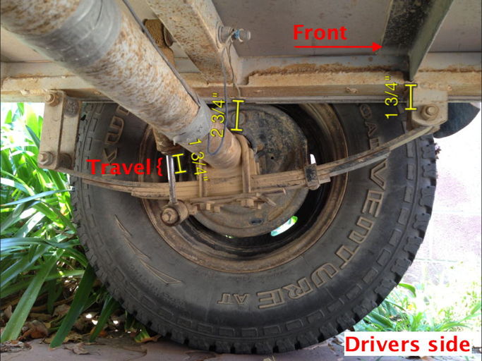

As you may recall, I've been complaining that the suspension of my TD is too stiff, the trailer bounces, and we broke a couple of leaf springs 80 miles down a washboard trail in Baja Mexico. I've been theorizing that longer YJ Jeep springs might be the answer. Well, today I took the TD over to Off Road Evolution in Fullerton, CA and talked with Mel. He is good with off road suspensions.
I have to say I was surprised at his advice (but I like it). He pointed out that you can see almost 2 inches of travel on the shock shaft. It is shiny there. So we would not want to add much more travel or the trailer will be bottoming out all the time. We could use YJ jeep springs, but he's not sure that would be better. Actually, he recommended against that.
Or we could do a spring over axle lift to create more room for travel, but if we make the jeep too tall there is a serious danger of it tipping over or rolling over on the trail. He has seen that happen several times. So he didn't recommend that either.
The best solution is to use bigger tires & lower pressure (especially on the trail). He said no reason not to use the exact same 32" tires on the trailer as the Jeep already has. Might need to raise fenders to make room for larger tires. But it's only three bolts, so no big deal. He also thought it would be perfectly okay to bolt a full-size 32" spare tire to the side of my trailer, since the trailer walls are 1 inch thick plywood.
He suggested a trail tire pressure of as low as 10 PSI in the trailer tires (if they are bigger). And back to the normal 35 PSI when on the highway. Same as the Jeep.
And as for the history of leaf spring breakage.... He said to carry an extra spring! That makes sense to me, so I bought a pair at Carson Trailer on the way home. I plan to find a place to affix it under the TD so I will always have a spare leaf spring.

This being the Offroad TD Axle & Suspension thread, I have to report that I broke 2 more leaf springs on the last trip to Baja Mexico. For a total of 4 broken leaf springs over 4 years. It was rough going, and those springs broke going very slowly. I think the wheel fell into a hole, or dropped off a rock then compressed the leaf spring until it snapped.
I'm going to tell you WHY my leaf springs keep breaking, and what I'm doing about it.
If you look closely at the photo in my previous post you can see that the shocks are mounted wrong. You don't see that? Don't feel bad. In 13 years, I didn't see it either. What is wrong is that the shock mounting bolts are not parallel to each other, not pointing the same way. One is twisted 90 degrees. It seemed ok at the time. But if you think about it, in addition to getting longer & shorter, part of what a shock does is to pivot on the mounting bolts. Fine. But not possible when the mounting bolts are not pointing the same way.
So what was happening was that everything was FINE when the shocks were broken off. And they were broken off for years. But I replaced them before the "big Baja off road trip" and that is when the shocks would restrict the motion of the leaf spring, putting all the forces on just half of the leaf spring. SNAP! When it broke we were hundreds of miles south of the border, and hadn't seen pavement or civilization in days. But that's a story for another post.
A DIRECT FIX
If I just left off the shocks or mounted them differently (bolts pointing same direction) I think the leaf spring would not keep breaking. That is certainly an option and a direct fix.

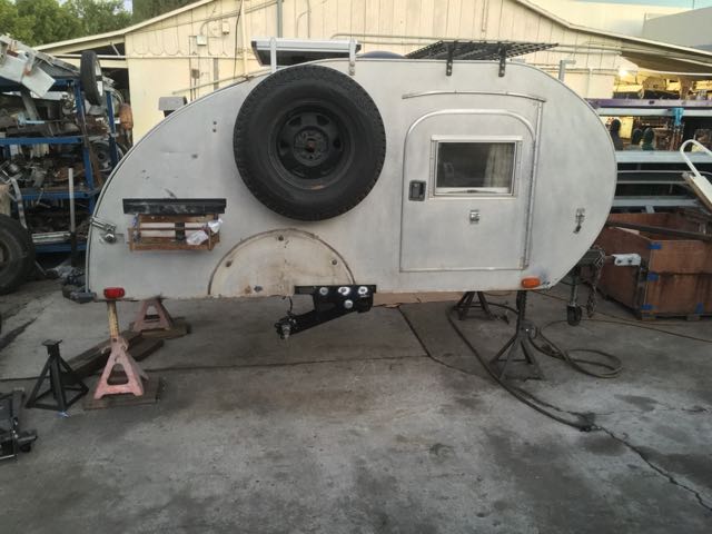

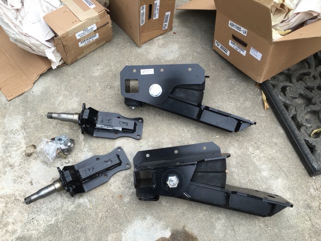

I bought a Timbren "axle-less suspension" . Part number ASR1T-HDS02 == 3500 # suspension (strong metal very thick), 1500# rubber spring (soft), & offset spindle for Offroad tires (8.5"), then down rated to 2000# for offroad use. Offset =hub face to frame = 8.5".

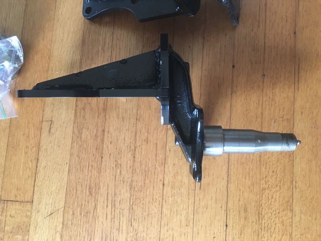

HOWEVER if you are an offroader, you probably want the 4" lifted spindles part number P025. I don't know what the part number for the whole kit is when it includes the lift spindles, but you can get that. Alternately, you can weld on some good square tubing under the frame to lower the frame, then bolt the Timbren to that. I'll get a build thread together.
I've taken only 2 trips with the Timbren, and it is much smoother riding than the leaf springs ever were. I feel this will prevent my trailer from getting so pounded by repeated bouncing & slamming. This is an important step forward for my offroad TD, so I wanted to mention it here. Search TNTTT for Timbren, or search for my posts and you'll find more mentions, plus I'll eventually get up a bunch of photos, measurements & findings about this suspension. In the meantime, the Timbren looks like a serious contender for an off road teardrop trailer suspension.
The 4" lift spindle

The Timbren kit part number ASR1T-HDS02 (with straight spindles) - you probably want the lift spindles.
