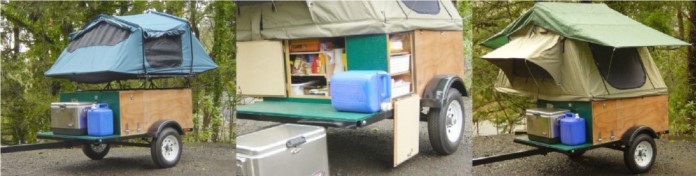

Something like this:

There's NO easy way to do a Yak. I built this rig because of the load and unload issues. The tent (ez awn) was added for overnight capabilities, however, the problem with this set up is the small trailer foot print and the height of the tent. Both caused stability problems.
I think you have two options.
Roof mount the yaks, and pull a camp trailer. This negates over hang and turning radius issues. The tent sits lower and allows use of your rear view. Down side is yaks on the roof. Wind noise can be annoying. Stacked yaks may allow a roof tent also. Be careful - most roofs only support about 200 lbs and if you have a small car it gets wobbly.
The next option would be a roof tent and a Yak trailer.
If your an avid yaker, don't worry about the price of the roof top tents, skip the Chinese imports and buy quality. I inspected both autohome and EZ, both are outstanding products. I'm big and needed more room is why I choose EZ.

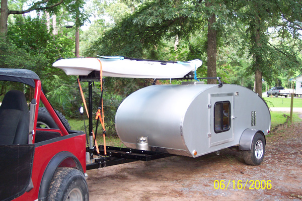

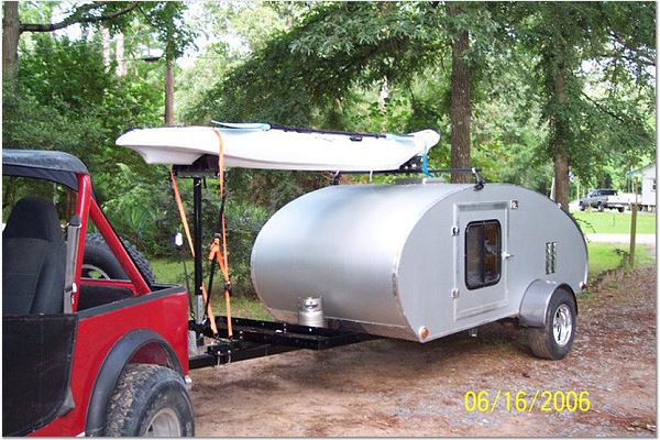

Have you looked at sonetpro's FishInn? It's in the Hall of Fame. He's an avid kayaker who carries his yak above his tear drop. The picture below might give you some inspiration.

Esteban, yes I have seen this one, and consider this as a good option for a smaller trailer. Ideally I would use the same type setup on the tow vehicle once at camp

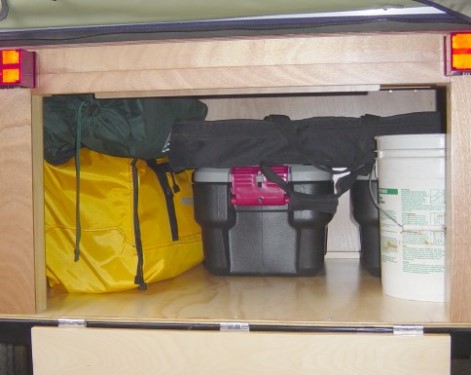

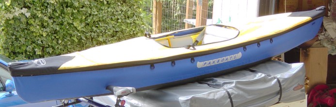

See the yellow bag in the back of my trailer?
It's a 12' folding kayak
Scott
