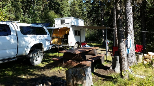

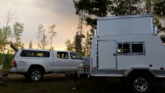

Its been a few years since I've perused this forum! When I did I realized I had never really updated this post. I thought I would share a few pictures and latest status of the trailer I built.

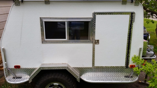

I have worked on a few things like steps/nerf bars around the outside:
Even in the rear which has proved to be very convenient:

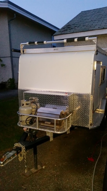

I added some items to the front also. I have found a nice 10lb propane bottle. A nice marine BBQ. A battery box and an additional piggybacked box which holds my four camp chairs:
Here are a few more pictures of the camper in action with the top popped:
I also got a new tow vehicle which I may or may not have gotten to specifically color match the trailer :thumbsup:

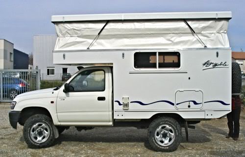

I am planning to add some solar to the roof in the near future which will mean that lifting wont be a easy. My plan is to add lifting shocks to the sides much like this:
What I haven't been able to work out is the racking effect as I undo the four corner latches and I am left with just one holding in a single corner.
I am open to others thoughts or comments on this! :)

asorensen wrote:I am planning to add some solar to the roof in the near future which will mean that lifting wont be a easy. My plan is to add lifting shocks to the sides much like this:
I think there are two ways that would prevent racking. You can mount the gas strut in a way so that it passes through it's shortest point and then begins to lengthen again prior to closing completely. For example, using the forward strut on the camper pictured, mount the forward part of the strut (on the body of the camper) so that it sits higher than the aft part of the strut (connected to the lid) when the lid is stowed. A friend's Sportsmobile is set up similar. He releases all of the latches first. The roof stays down until he pushes up on one of the ends from the inside.
The other option is go go with a beefy middle latch (there are three per side in your picture) and release it last. The lid will still want to rack from side to side, but you'd avoid all the stress on one corner.

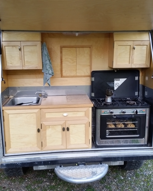

Here is a picture of my kitchen area I took while camping this weekend. May long in Canada eh! Yes those are peanut butter chocolate chip cookies in the oven! The frame in the middle is a pass through to table level inside.
I haven't done anything yet with the gas shocks for lifting the roof but I appreciate the responses. I think I like the thought of the shocks set up in a way that they move past there longest point. The was explained in I much clearer manner by loius75.
