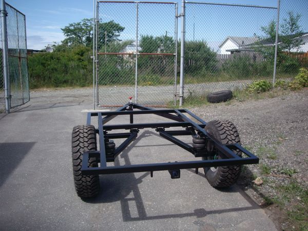

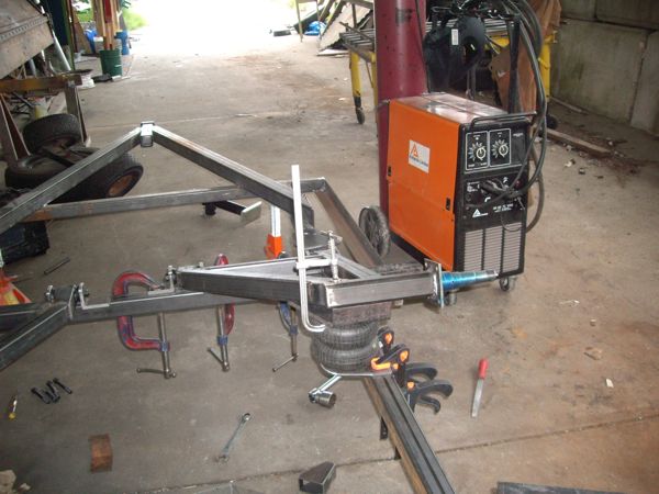

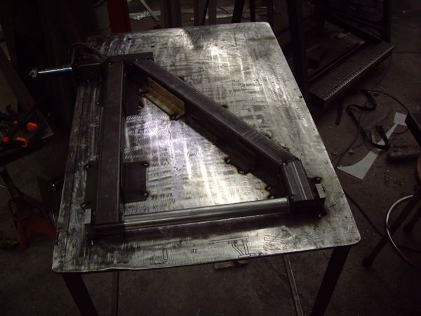

The trailer was the next major hurdle.
I had decided on independent suspension with airbags and shocks so I needed to make up swing arms.
Here is first swing arm and the jig:

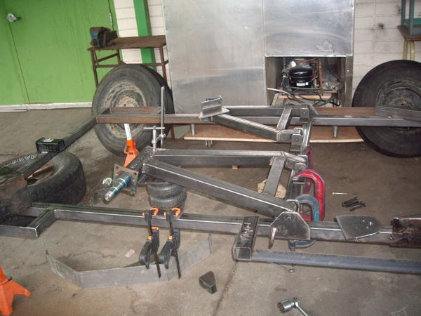

This is where the swing arm will sit.
With the airbag:
I planned to put shocks on as well but as I was running out of time I opted to try it without for the first journey.
The result was that I had to run the airbags with quite a bit lower pressure than I had initially planned. This was to deal with the rebound issues after which it towed quite nicely.
Needless to say the obvious solution is to fit shocks as well which I will be doing soon.

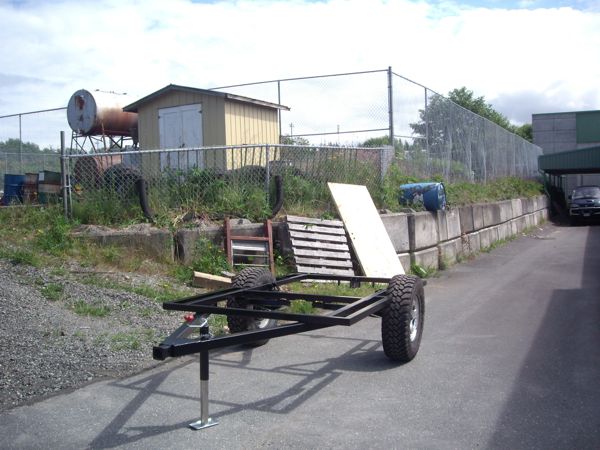

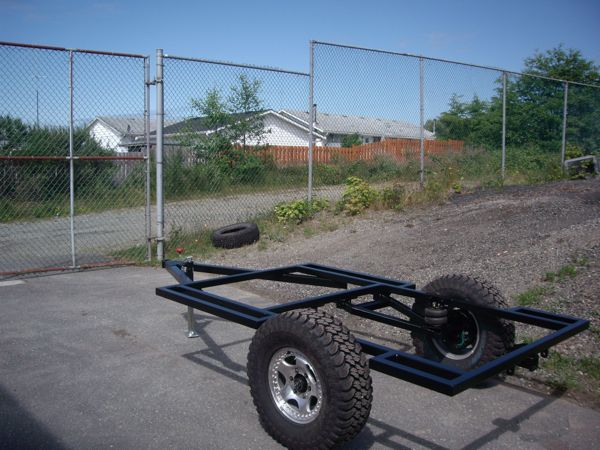

Anyways here is the trailer all painted up.
