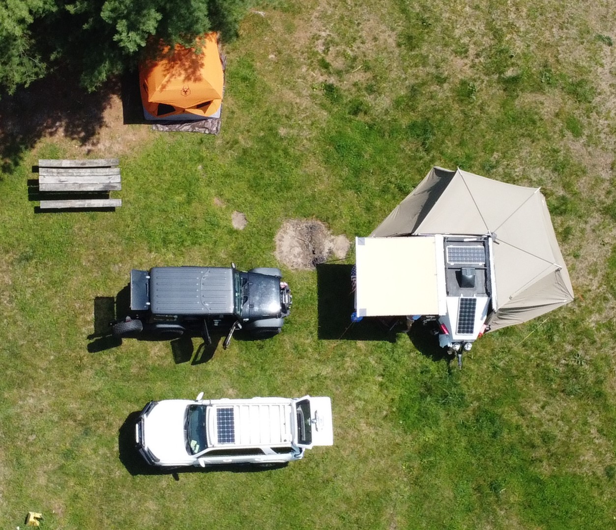

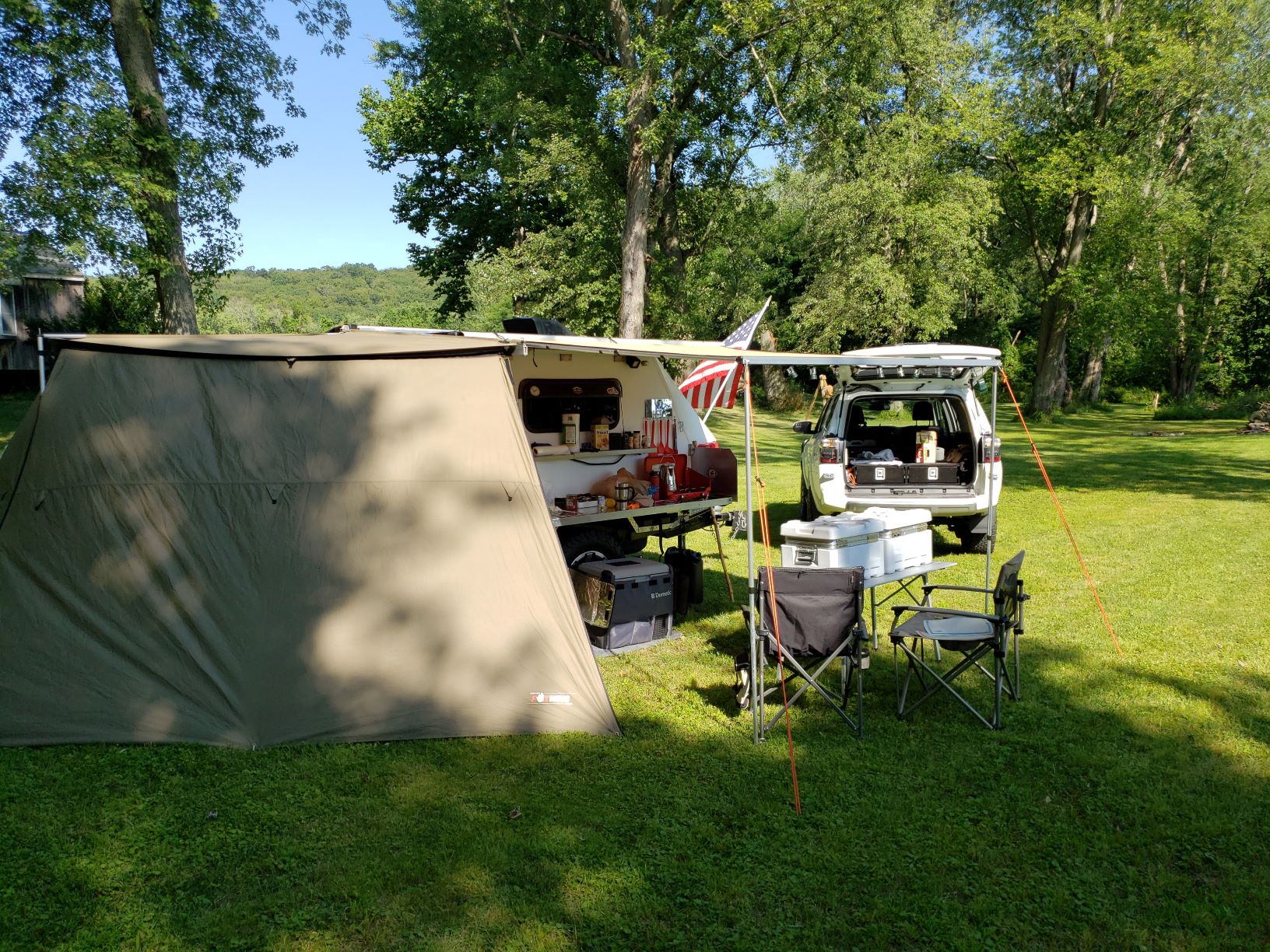

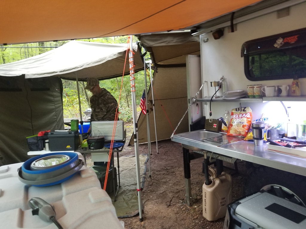

Postby titanpat57 » Mon Sep 13, 2021 8:08 am
[quote="3GKnight"]Sweet. Can you post a picture with the sink/counter down? Thanks![/quo
My apologies...haven't checked back in awhile...
Here's a few more from various adventures...thanks for looking
