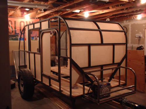

Ok, here is the situation. I have a 1990 Geo Tracker that does pretty good off-road for what I have in to it. I need an off-road teardrop that would be light enough to not drain the little 4-cylinder of all of its life force.
I've been kicking around the idea of a tear based on the body dimensions of 5' wide, 4' tall, and 8' long. I'm looking to stay under 450 to 500 lbs total as a goal. Any chance of doing it? I was thinking about a nice solid built steel frame. Add an aluminum skeleton for the body. Either 1/4" or 1/8" birch or 1/4" luan plywood on the inside. Fully insulated. 0.040" aluminum sheeting for the outside.
I would use triangulated cross braces in the front and also at the rear bulkhead simular to what I did on the front of my first teardrop seen here.
Also the side walls would be tied together at the front and rear of the countertop by a tube of Aluminum running side to side. I imagine that this should give enough rigidity to keep the sides from racking when traveling down bumpy single tracks and washed out roads.
The aluminum body would bolt down to the steel frame. Either spring or torsion axle, not sure yet though.
If you use the figure of about 135' of tubing for an estimate I come up with the following weights:
1"x1" - 0.062" aluminum tube = 0.2729 lbs/ft = 36.84 lbs
1"x1" - 0.125" aluminum tube = 0.5132 lbs/ft = 69.28 lbs
1"x1" - 0.065" steel tube = 0.8264 lbs/ft = 111.56 lbs
I figure that I would use the heavier AL tube for the outside of the profile, the diagonal braces, the cross braces, and the door jambs. For all other horizontal stringers and verticle studs I would use the lighter AL tube. So if you split the difference then you end up with a body skeleton that would weigh in at 53.06 lbs.
The aluminum sheet weighs in at 0.58 lbs/square foot.
Figure 2 sheets 4'x8' would be another 37.12 lbs.
Figure a sheet 5'x15' to cover the front, roof, and hatch would be 43.50 lbs.
We're up to about 135 lbs.
I'm not sure what the weights for the plywood would be though. Any ideas on how to design the chassis? My thought would be to use 1.5" wide x 2.5" tall - 0.083" tube for the perimiter of the frame and maybe 1.5" x 1.5" - 0.083" for the crossmembers. 1/2" baltic birch floor. Triangulated tongue with a receiver tube for a removable tongue.
Well it's getting late and my ideas are starting to run together. I had better stop and let them collect again overnight.
Let me know what you all think.

Mike, here's a selection of thoughts in pretty random order:
M. Olsen wrote:I'm looking to stay under 450 to 500 lbs total as a goal.... I was thinking about a nice solid built steel frame.
You can have 'lightweight' or you can have 'nice solid built' - mixing the two will get you neither. 'Strong enough' needs to be your goal if you want to build light.
There are no racking forces on a trailer, because they sit on three points (two wheels + hitch) so they can't get twisted like a four-wheeler. There are some small inertia loads that will twist a trailer a little, but the lighter you build, the smaller those loads are.
A sheet of thin ply is a superb anti-racking structure - your diagonal struts won't do any harm, but they're just extra weight that's not needed. The critical thing is to make strong joints along the edges of the plywood sheets - the aluminum tubes will do that, though maybe not as well as wood would. Interestingly, your lightest aluminum tube is exactly the same weight as 1"x1" solid wood.
I think your aluminum tube body would probably work as well as an all-wood body, be as light as an all-wood body and be no more than twice the amount of work to make.
Your frame tube sounds a good choice but I would have to question what all the cross-members are for? Does 1/2" ply need any support if you're only going to lie, not dance, on it?
I'm not 100% sure what your tongue design looks like, but it sounds like the heaviest possible way to connect the trailer and the tow vehicle. The lightest/strongest is a simple A-frame - that's why all those trailer manufacturers use it.
Point taken. I guess I'll have to do some thinking and define what strong enough is. Remember that I'm not an engineer, so I have a tendency to overbuild things and this project will go against those instincts. I just don't want to go too light or not strong enough and have it fail at the most inopportune time.
There are no racking forces on a trailer....
If I can entice a Grizzly bear to place his paws on the top of the trailer and push would I then have a racking force? :lol:
So what would be the best way to attach a thin sheet of plywood to an aluminum frame work? The Redneck Trailer Supply catalog lists a 3M tape called VHB Series 4611. I think that it would be outstanding in this application if you can get past the price of the tape. More information here.
But which would be stronger?
...and be no more than twice the amount of work to make.
Ahh, that's where the skilled labor force comes in, the FFA students.
For my tongue design I want the flexability of an adjustable / removable tongue. I know that this will add a substantial amount of weight to the front, but that might be one of the compromises that I would have to live with. I agree that a simple A-frame would be light and strong which goes back to using geometry in stead of just sheer mass.
Andrew, thanks for the comments and insights. I like this type of discussion because it provokes mental gymnaastics on my part.
More to think about before I fire up the CAD program.

Postby angib » Wed Aug 30, 2006 4:18 pm
M. Olsen wrote:If I can entice a Grizzly bear to place his paws on the top of the trailer and push would I then have a racking force?
Sure, though it's likely the bear's paws will punch through the plywood long before the whole box collapses - it's often local strength/toughness that determines ply thickness, not overall strength.
Not enticing the bear would be another excellent design choice.....
M. Olsen wrote:So what would be the best way to attach a thin sheet of plywood to an aluminum frame work?
Epoxy glue would be very good and cheaper than VHB tape, though you would need to think of some way of clamping the ply against the tube until the glue sets. A pop rivet every 4" or so would do it, but they might pull through the ply.
However VHB tape is the absolute dog's bollocks (this is a technical term, not offensive swearing...) and very easy to use. You might ask a local adhesive supplier if they have a cheaper alternative - I used to buy tape for work at half the 3M price.
