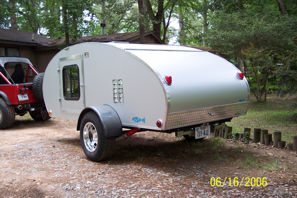

Postby Sonetpro » Fri Sep 08, 2006 9:42 am
I used a 3000lb axle with 2000lb springs I also added Jeep shock's. Tires are 235x70x15 The bolt pattern is 5x5.5 same as the CJ. The clearance is 19" the same as the Jeep.

Postby Dave Nathanson » Fri Sep 08, 2006 11:00 am
Hi SteveT,
That looks great!
Does your TD come off the ground when you hit a rock? I'm wondering about springs, and how light or heavy they ought to be. Our TD really gets airborne when I hit a rock at 15mph.

Postby Sonetpro » Fri Sep 08, 2006 11:42 am
Hi Dave,
It doesn't get airborne. But I don't go rough offroading with it. Just rough beach to the secret spot. The shock's seem to keep the tires on the ground.

Sonetpro, I love your Teardrop! Looks like it has been there and back!
