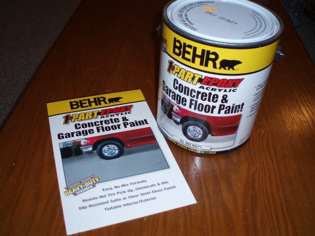

I just bought a gallon of this stuff...
I'm going to test it, starting perhaps this weekend, and if it works well, I might coat my next teardrop with it.

mikeschn wrote:I just bought a gallon of this stuff...
I read the directions on a can of Garage Floor "epoxy" at HD and it indicated that it was not for use on vertical surfaces. They didn't have the Behr. Do the directions on Behr give any indication concerning veritcal surfaces

Postby mikeschn » Wed Feb 07, 2007 6:49 pm
Yea, my can says the same thing (no vertical surfaces) I can't imagine why, unless there's a problem with runs.
Anyone have any ideas?
