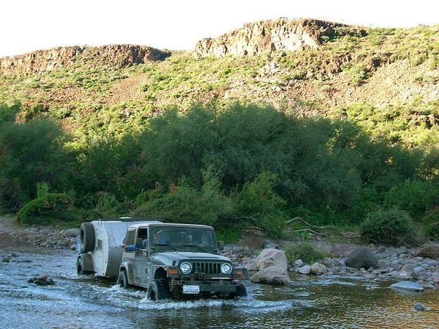

Is there anything special I need to do when building the teardrop to make it more suitable for water crossings? I'm thinking of some sort of plate at the front of the trailer where the body mounts that is angled back like the front of a flat bottom boat. I'd hope this would create a small bow wave and push the water under and around the trailer, but I dont want it to start floating :shock:
My Jeep does not see water crossings every trip but one of my favourite spots has several fords (7) to go through and then a river crossing which can be anywhere from half way up my wheels to just over the front bumper. I'm not sure what that actually is in real measurements so I'll post a pic of the Jeep for you to get an idea.
