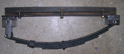

Yes, I've built a trailer with a moveable axle. I've never moved it however. I'm building a teardrop now and the axle will be moveable. Here is a picture of the way it will be (I've fabricated some of the parts already). Let me know if you have any other questions.
Given that the load from the springs is spread along a larger portion of the rectangular tube frame, it should be stronger than just welding the spring hangers to the tube. Also the angle iron is thicker (stronger) than the frame. Just slide the axle till you get the balance you desire, mark, drill, insert the strap nut from the rear of the frame tube, and install the bolts. If your frame has a sharp corner you can mill out the radius on the angle so it will bolt up to angle or channel iron (tubing with it's radiused corners doesn't have this problem). See my album for picutures of a trailer with a channel iron frame and a moveable axle.
