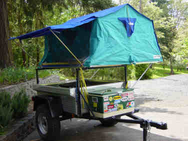

Here is an off-road trailer I built,
For off-road, I like the trailer to have the same wheel track as the tow vehicle, this becomes useful in rough terrain when wheel position is critical for making it thru an obstacle, the trailer should take the same path as the tow vehicle.
Match the trailer hubs and tires/wheels to the tow vehicle. This way you can use the same spare(s) on the trailer and tow rig.
Use a receive tube style trailer tongue. This way you can tow with a normal ball and couple on the road, then switch over to a three axis pivoting style one of off-road.
Also what everyone else has already said ...
Scott
