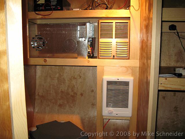

Postby mikeschn » Wed Dec 31, 2008 6:43 pm
You might consider building a giant teardrop, and not use the galley when it is THAT cold outside.
Check out the Generic ET build in the hall of fame. We used it in some cold weather this week, and it worked really well. Cooking, or warming up foods can be done in the inside galley.
We were all electric, but I have plans to put in a forced air furnace on one of the bathroom shelves.

mikeschn wrote:You might consider building a giant teardrop, and not use the galley when it is THAT cold outside.
