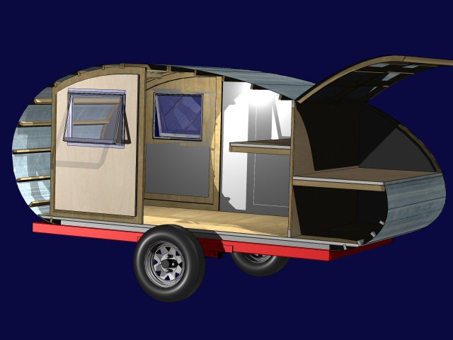

For lack of something better to do (no funds and it's just too darn cold to work outside), I have been playing around in Sketchup with the Superleggera from the design library. I would have to check; but I think our resident engineer calculated that one to be 174 Kg (383 pounds for those on this side of the pond). I would think an Escort could probably handle that; but don't quote me on it.

Postby tinksdad » Sat Jan 17, 2009 4:07 pm
I noticed there was only about 50 pounds difference between the two. I was just throwing another option in the ring. Too much spare time on my hands.
The ease of getting a title would probably outweigh the weight difference.

Postby tinksdad » Sat Jan 17, 2009 4:22 pm
Just a past time when I get bored. I have been thinking about building another lite weight for re-sale to help finance my next one. I'm torn between going with the Paddy Wagon I've sort of all ready started and making a complete left turn and doing a SlumberCoach clone (if I can find enough pictures to work from). My skills are no where near some of the designs I've seen you put up here.

Postby mikeschn » Sat Jan 17, 2009 4:26 pm
tinksdad wrote:Just a past time when I get bored. I have been thinking about building another lite weight for re-sale to help finance my next one. I'm torn between going with the Paddy Wagon I've sort of all ready started and making a complete left turn and doing a SlumberCoach clone (if I can find enough pictures to work from). My skills are no where near some of the designs I've seen you put up here.
Your slumbercoach design that you did in Sketchup looks fantastic. That would be a really nice build. You would not regret that.
