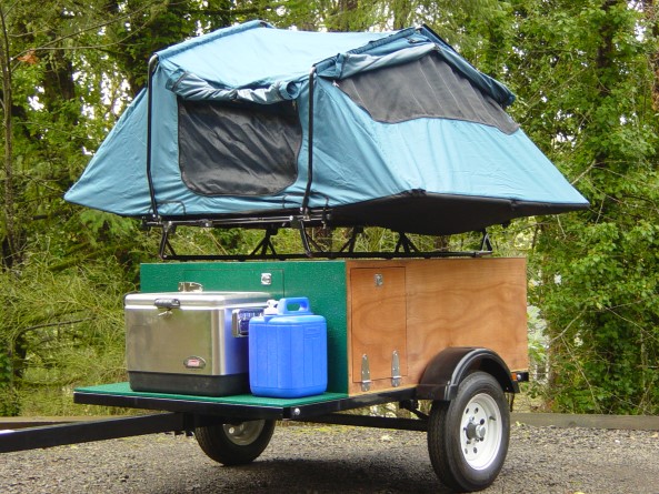

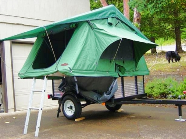

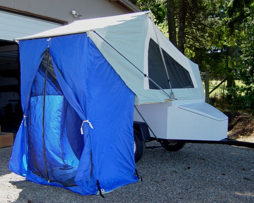

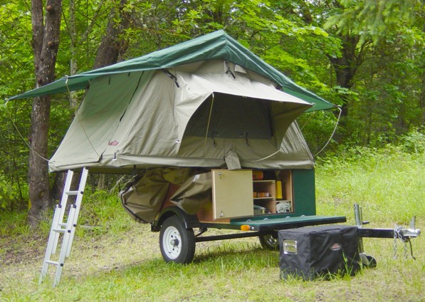

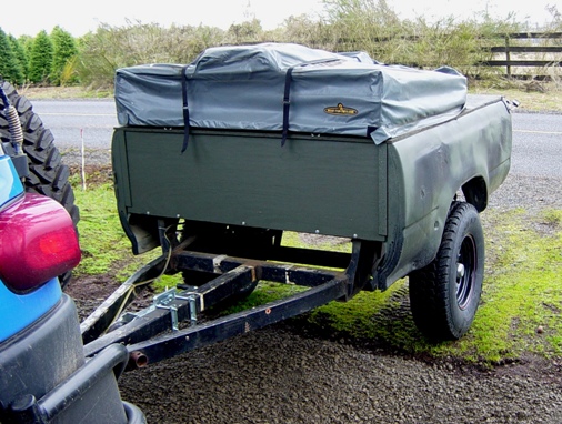

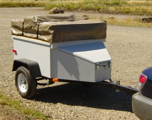

bytehoven, I'm a big fan of and build camping trailers using the "Tent Topped" approach.
The most basic multi-purpose approach is mounting a RTT on a trailer so it's easily removed for other duties. Then making some sort of a Drifta like kitchen / campbox setup.
Pickup bed trailer also work nicely.
The other approach is building a dedicated camping trailer box that is removable, although still using a folding Tent Unit for sleeping quarters. I prefer doing this on a flat bed trailer.
Before having the trailer frame built, IMHO it would be benefical to have a "plan". That way it gets built "right".
If you're going to have the frame custom built, have the track width made the same as your tow vehicle. Also, at minimum match the tow vehicles lug pattern, so you only need to carry one spare. I would also match the tire size.

RJ, yes you need a bit of sleeping space, your could go the "two bedroom" route, (two RTTs) although that would notably add to the expense.
Since I designed and built all the above pictured trailers I have info an them. You will find a complete build story on the third and fourth pictured trailer at Explorer Pod
I call the trailer in the fifth and sixth pictures an Explorer Box. I've actually written a detailed construction manual on building one. Check it out at Explorer Box.
On my web-site I also have a collection of interesting trailers that will most likely spark ideas at Interesting Compact Campers
My rule of thumb is to have the axle 2X my planned GVW. Where a 5K axle might help is with the bigger bearings if you're running big off-set rims and heavy tires (33"+).
Yes, carrying an extra spare isn't a big deal. If someone plans on keeping a vehicle for a while, I finding matching the lug pattern to be a good idea.
