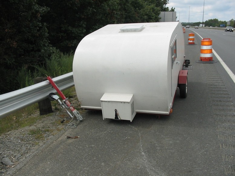

Postby Arne » Tue May 18, 2010 7:34 am
You mean like this?
www.freewebs.com/aero-1
Arne
Mr. Subject Line
Posts: 5383
Images: 96
Location: Middletown, CT
Postby Shadow Catcher » Tue May 18, 2010 9:01 am
Arne
Do you know anything of the back story on that picture?
I have seen pictures of one other tear in an off road situation where the single tube tongue broke.

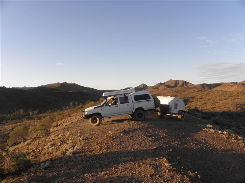

Postby deepmud » Sun May 23, 2010 2:17 am
Now that is more than a bumpy road, lol.
I haven't got pics of the trailer on the REAL off-road trails - I have an old 8mm Sony video that needs to be converted someday then I'll have a fun demo :D
