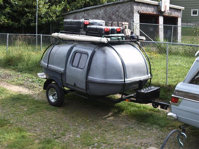

Postby boxcar » Sat Dec 04, 2010 8:57 am
How about a roof rack?
