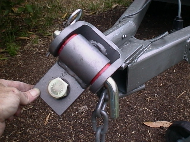

Postby Steve F » Wed Apr 13, 2011 3:30 am
I have an orac coupling. Cheap, ADR (Australian Design Rules) approved and has unlimited articulation. Quite easy to hook up again as well.
Down here in Australia you never see a hook and pintle setup on anything that is not agricultural, military or heavy vehicle.
