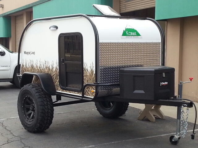

Below is the extreme off road teardrop we have ordered to meet our needs.http://www.kodiakap.com/

Then you are talking more about something like the Krawler model TD made by SoCal Teardrops. Mojave Road and Death Valley are in their backyard. I think a link to there website is provided above. Nice trailers with a nice price, 22k+ with the options most would like. I considered one before the one we chose. In my opinion you need at least a 31" tire 18" of frame to gound clearance. Tongue and rear should be able to handle some contact with the ground with out damage especially if you will not be crawling over boulders on the Rubicon trail.
