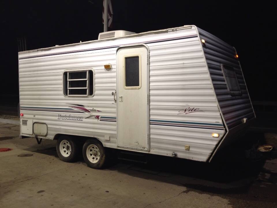

Hey folks good morning! I woke up this morning and had this idea in my mind. A couple months ago I picked up a 1999 18ft camper for $400. It has really bad water damage in the front end. I had grand plans to restore it but my buggy projects take priority. I want a small camper area about 6ft long and 8ft wide by 5 ft tall. Or Bob the camper and build it to a standing full height and have a 6x8 floor area and a 3.5ft rear facing loft for a sleeping area the the buggy will sit on the trailer with the front tires under the loft area. This trailer has a 17 ft long bed area the wheelbase on either one of my buggies is 98- 100 inches so I'm pretty stuck on the 6 ft x 8ft floor area. Does anyone have any ideas? Or alternative design ideas. I quickly drew some of the ideas I have and am including pics of my trailer, buggies and tow vehicle to help with suggestions.

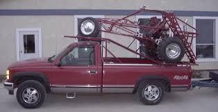

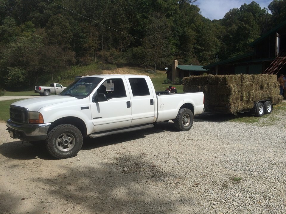

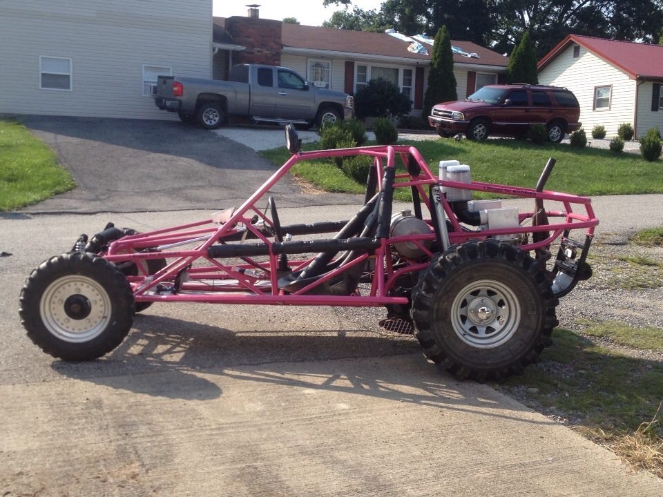

heres the tow Pig im collecting tubing to build the buggy rack for the bed. it will slid in and out as I need the trucks bed.
Heres how Im gonna haul my hill Climb buggy when towing my Tiny toy hauler. I have a 99 ford f250 4x4 Crew Cab Longbed as a tow vehicle.

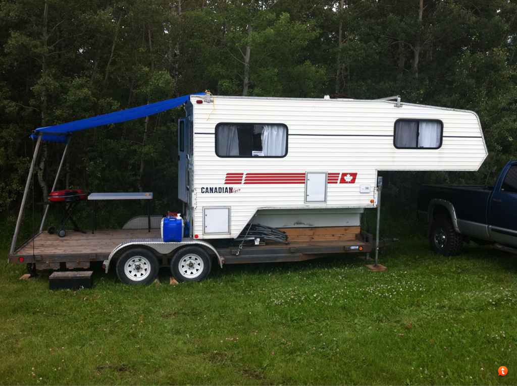

I will be cooking outside of the camper area and ill be using the AC/heater and the fridge in this. The full height idea is similar to this setup but with a loft area to the rear cargo/buggy area. basically the same side wall design as a truck bed camper turned backwards when the buggy is loaded the front of my pink buggy will sit under the loft area. Camper will have some of the windows and the full door on the side. Basically im bobbing the camper so I can roll a buggy upon the rear of the trailer and have an area to relax and recover from my daily bumps and bruises. I do like the idea of having a set up where i can cover the rear area to get in the shade or have my buggy covered while parked.
I know this isnt a teardrop or tiny trailer but this is the best place ive found that has forum members that seem to want to help and give ideas! i do have plans to build a small tear edition of this so i can just have a lil sleep area and have ramps going up the back of it for my single seat hill buggy.
