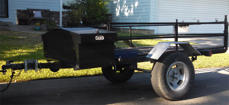

I had a leftover UTV trailer that I used to move from San Jose, so I was just going to use that. Luckily, the previous owner had swapped in 30" Jeep lift springs but left the wimpy 2000lb axle. First order of business was replacing that with a 6 lug 5200lb axle and springover kit for additional lift. That still was not enough lift so I made some 9" 410 stainless shackles to lift the leaves up even more.
trailer when I first got it
trailer 1.jpg (111.97 KiB) Viewed 9602 times
trailer as utility version

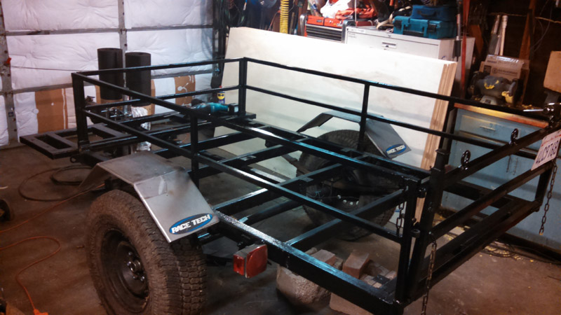

with 5200lb axles, Toyota 4runner spare wheels and 31" tires. Cheap wood base stripped off and frame painted black
start of frame
trailer frame starting.jpg (139.91 KiB) Viewed 9602 times

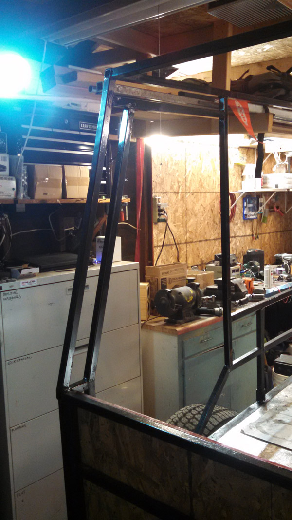

Starting to weld the frame on. Using .120 mild steel 1x1 for main frame

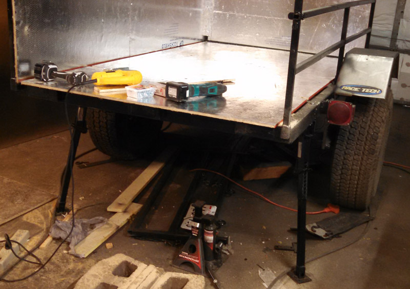

starting interior walls.jpg (167.92 KiB) Viewed 9600 times

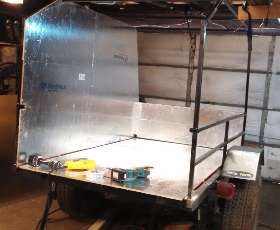

Here I have finished the frame and the lift and have started doing the interior walls I figured that radiant barrier sheeting would have some R factor for insulation. I will also insulate the trailer as well.
rear supports.jpg (132.66 KiB) Viewed 9600 times
Extended rear supports for off road levelling

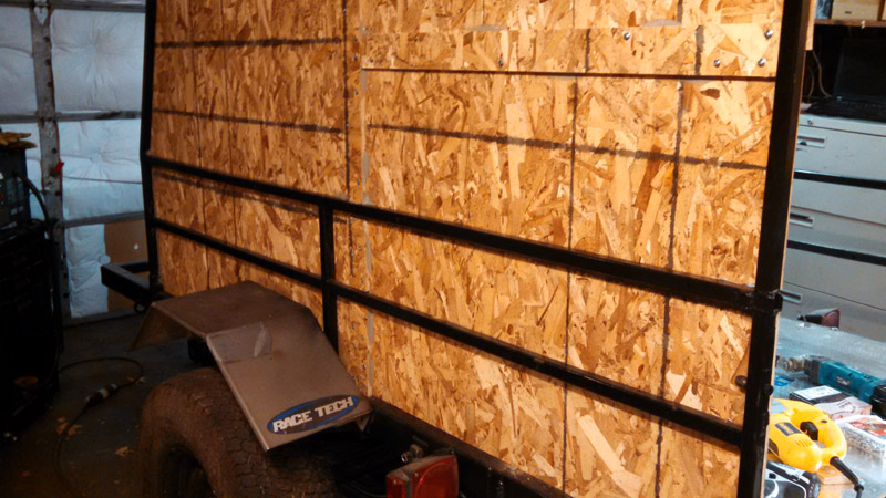

View of the outside of the interior walls
external wall view.jpg (153.36 KiB) Viewed 9600 times

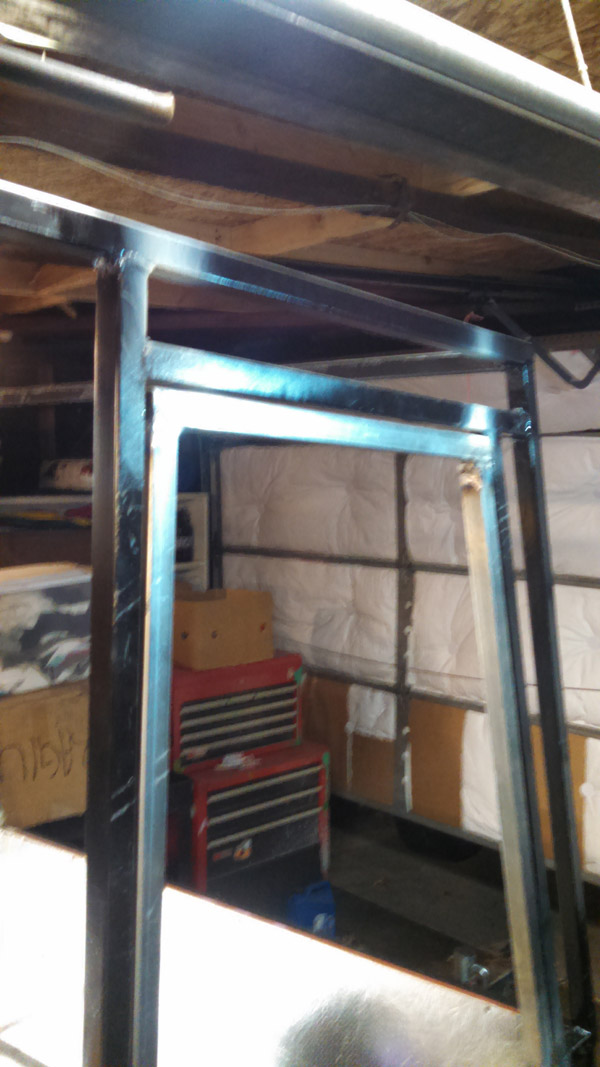

door frame
inside view door support.jpg (189.47 KiB) Viewed 9597 times
View of the door supports from the front of trailer. These supports are made from .095 steel to save weight

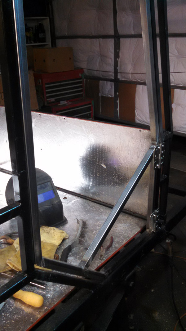

lower door
lower door detail.jpg (153.11 KiB) Viewed 9597 times
Lower part of door showing bracing to prevent sagging
