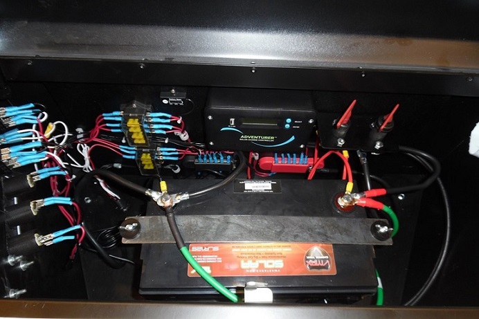

Postby ArkansasDon » Fri Feb 21, 2020 9:17 am
Watts, amps & voltage is the equation, watts = amps x volts, or W = A x V. If you want to know how many different 12v. electrical devices you can have on at one time, this formula will explain to you. As long as you stay under the amount of available wattage, your circuits will run smoothly if you exceed your available wattage you will end up over loaded.
The size of battery or amount of batteries will depend on you wanting how many (ah) amp hours & 12v. equipment to run. On my last trailer build I choose 125ah VMax Tank AGM battery which gives me 62.5 hours 50% of what is listed & you will see why I say 50%. 12v. equipment I run 40 qt. Engel portable 12v.\110 fridge\freezer which pulls (depends on weather conditions) 1.0 ah to 1.7ah on demand, Endless Breeze Fan 12v. pulls 1.3ah on low 1.7ah on medium speed continous, AT Overland Forced Air Heating Sytem 12v.pulls 1.6 ah & runs off propane on demand, cell phone charging 2.0ah continous, Handheld GPS 0.5ah continous, LED lighting (interior & exterior) can run anywhere of 0.65ah on up continous. I run all what I listed, some @ different times of the years (camping seasons). Regularly I run my Engel fridge, charging a cell phone, running lights on & off, charging GPS unit, on fair weather camping, cold weather I'll run AT Overland heater, Engel fridge, charging a cell phone & GPS unit, Hot weather, Engel fridge, Endless Breeze Fan (sleeping time hrs), cell phone charging, charging GPS unit.
I have 2 sources of charging: solar Renogy 30amp Adventurer Charge Controller, 100watt Renogy folding suit case monocrystalline panel, 2nd source of charging is 55amp Powermax Converter Charger 3 stage. I can run inverter generator on this & power my 12v. equipment & charge my battery, & I can run 110V too shore line power to charge my battery & run my 12v. equipment at the same time. Solar is only as good as you have sun light, overcast condition depending on the quality of solar you have is 15 to 25% of their typical output on a cloudy day. This is why I have the second source of charging by power converter charger 110 to 12v. I never run my 125ah battery below 50% but it's recommended you can discharged down as much as 80%. If a battery is discharged to 50%, it will last about twice as long as if it is cycled to 80%. I never ran my battery below it's recommended discharged level, my solar on sunny days has always kept the battery @ a full charge level w\ a reserve for night time use.
