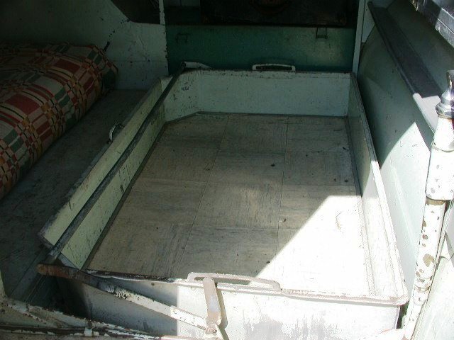

As well as building a standy, consider building a drop-floor. Here is a vintage trailer with a neat all-metal drop-floor mechanism:

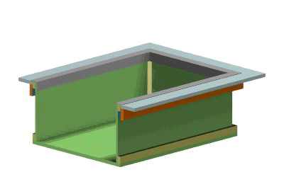

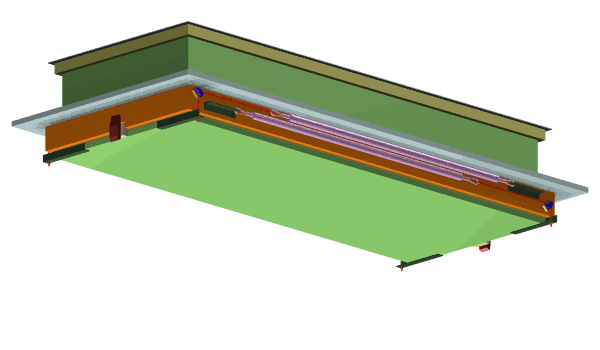

And here is a drop floor all in wood:
In case it needs explanation, the blue cleat/strip inside the static frame is removable - it is easy to design drop floor systems that are impossible to build and by unscrewing the blue strip, the whole drop floor can be removed for maintenance or repair.
Alaska may mean too much dust to allow a moving device like this to be used, as it would need some care to seal from dust.

I've thought of a drop floor before, but I planned on canvas sides. It could be held UP buy slide bolts on the inside , a flange and gasket underneath could seal it. If its not warm the fabric would be more tolerant of in level ground.

Postby angib » Sat Feb 27, 2016 6:37 am
It's a shame that the way I created those animated GIFs, one goes up when the other is going down!

angib wrote:It's a shame that the way I created those animated GIFs, one goes up when the other is going down!
I think that's good! That way, what you don't notice in one, you see in the other. :thumbsup:
