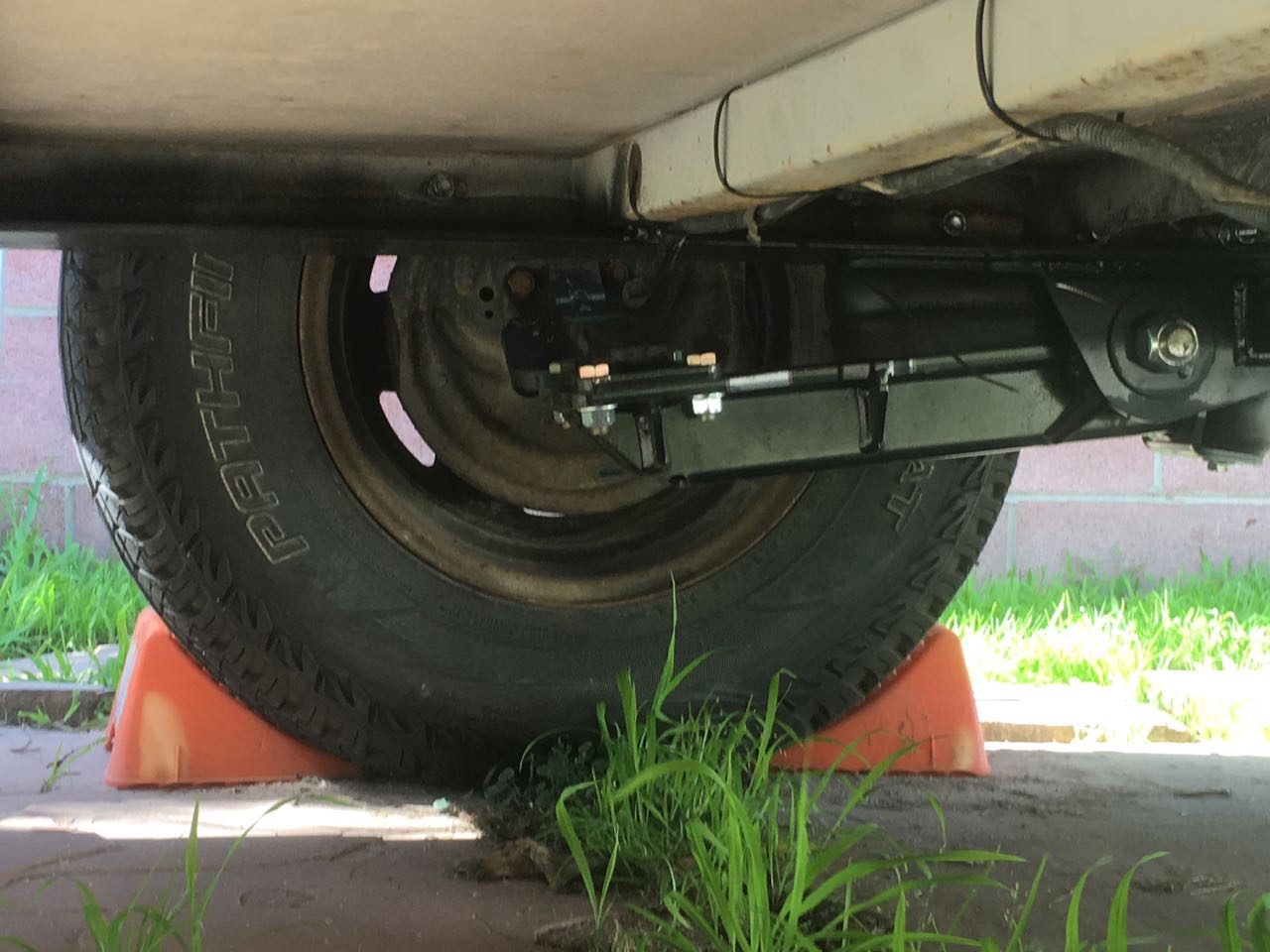

Here is a photo of the inside drivers side wheel, looking from back to front. You can't see the cross bar, but you can see the spindle height, which is pretty close to the trailer frame height. This is the straight spindle. I'm going to get the 4" lift spindle in next week. That huge shiny bolt is the suspension pivot.

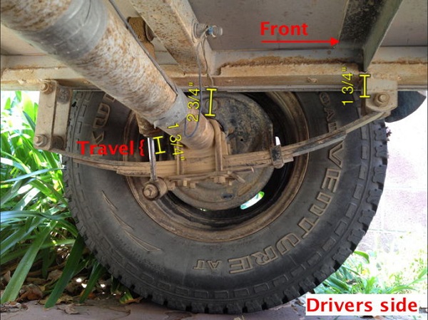

I left one point out of my dissertation above: both times that I've experienced broken leaf springs (and the one-unmentioned shackle tear-off) there was no bumpstop to cushion/limit the flexing of the spring past its' working arc limits. In the case of Dave's spring breakage, the leaf spring had nothing limiting it from flattening out, or even reversing its' normal arced shape (except for the shock bottoming out), resulting in a severe jolt, and breakage.

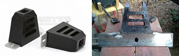

I chose not to use shock absorbers with my new leaf spring suspension (with relatively little travel), reasoning that the shock absorbers couldn't absorb enough energy in their limited motion to do much good before their absolute stop was reached.And, I was going to add a bumpstop to prevent the possible overtravel of the leaves past the flattened arc stage. So, I combined the functions of shock absorber and bumpstop into one, using a Daystar progressive bumpstop, made of resilient polyurethane, as an active part of the system (always in contact with, and following the motion of the axle); sorta like Timbren does with their component. I described my "active bumpstop suspension" in my thread: http://www.tnttt.com/viewtopic.php?f=35&t=59570#p1075076.
Daystar progressive bumpstops ku09016bk.jpg (45.43 KiB) Viewed 17202 times
I modified the Daystar bumpstop to be softer-acting (by cutting away the hard "bump" of the top of the piece, and curved the remaining body to slip-fit between my axle and frame (at full droop of the springs). With the top part of bumpstop so modified, the remainder relies on the two lower "ligaments" to progressively flatten out, before compression into the bottom layer, when the overtravel is finally prevented. I wondered how well it would work, as did may doubters on the forum, but I think it proved itself when I encountered a large chughole in the road at 75 mph. My truck and trailer both got bounced into the air, with my truck tires being the only damaged parts afterwards. In normal driving situations, I really haven't noticed any of the trailer bounce that I should be seeing, as a result of using too stiff of springs. In any case, the bumpstop at least kept the leaves from overflexing, preventing breakage. If I ever soften the suspension, and/or add conventional shock absorbers (if suspension travel becomes greatly increased), I will still use some form of progressive bumpstop to limit overtravel. I try different things, sometimes re-purposed from originally designed function, to do what I need them to. Sometimes it works....

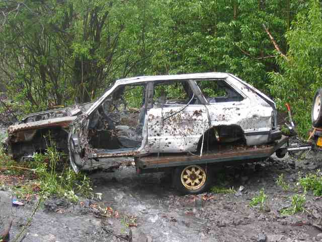

After over 20 years of hard use, I'm really happy with the massive clearance of the trailing axle design. You ignore the trailer clearance, just drive the tow rig - but it's not about primarily clearance - it's soft riding because it has low un-sprung weight, something a solid axle just will never have. Soft riding at speed over dirt roads with a few hundred pounds to half a ton or more of load - not clearance while crawling over rocks - although, my trailer clears rocks with little bitty tires as well as my solid-axle Suzuki with 39.5 Boggers.
here it is about 10 years ago with 2200 pounds of flooring on it - I've packed the bearings once since then. And put 15" rims on it. Durability test: passed. 20k miles of highway - passed. Soft riding, doesn't beat up my camping gear - passed.
Carries a crap-ton offroad? - passed
Of course, the 1989 Subaru axle may turn out to be more durable than a Timbren - but it looks pretty good - I'm looking forward to more input.
