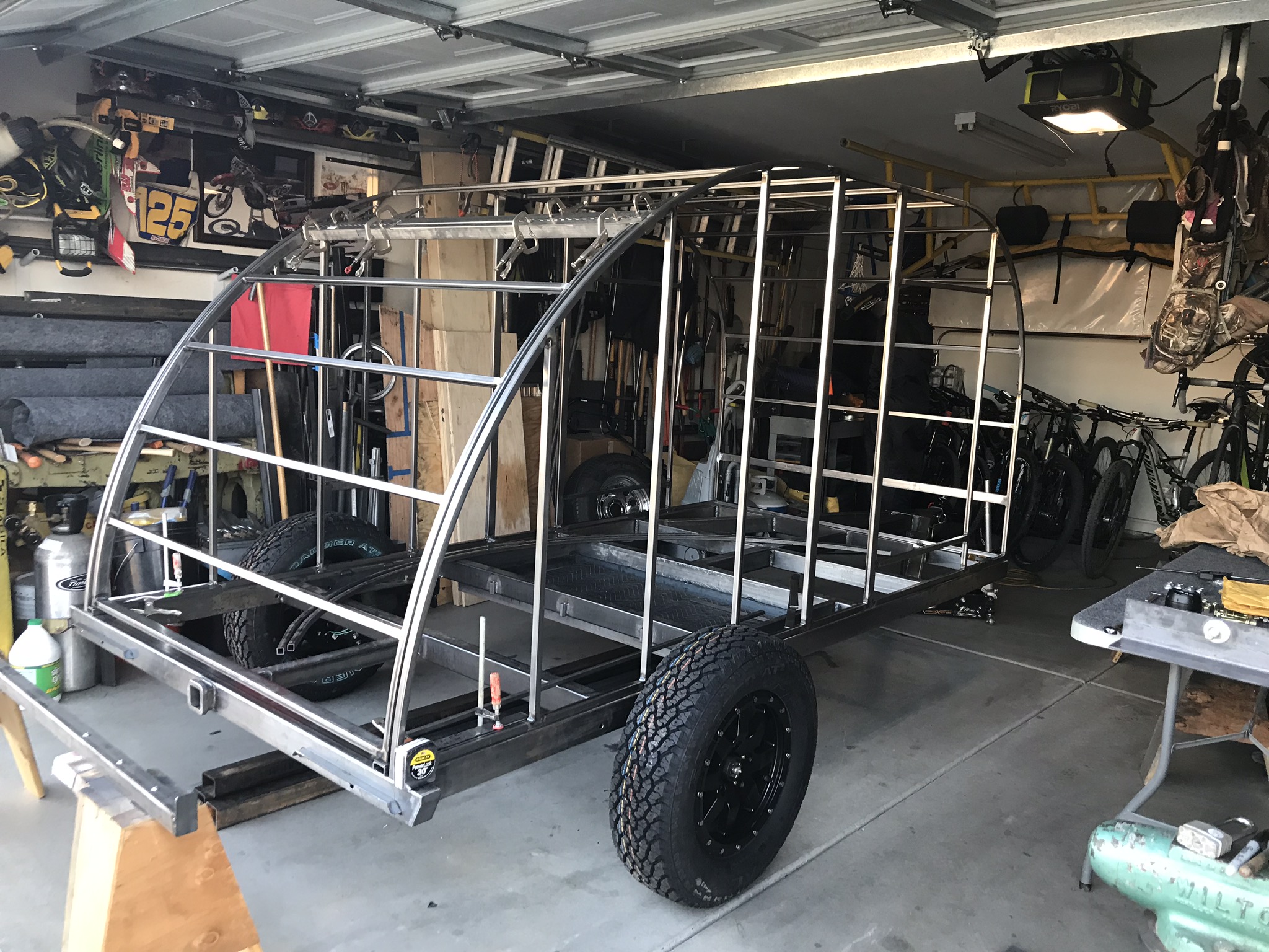

Postby ricky herbold » Sun Aug 18, 2019 8:19 pm
I went with the steel inner frame.

Postby retep » Wed Aug 21, 2019 9:12 am
I am so jealous. I wish I had the knowledge to weld like you. Still toying with going that route.
May I ask how much time you spent (approx) welding trailer, walls and bends to this point?

Postby ricky herbold » Sun Sep 01, 2019 8:15 am
The walls are not bad at all. I rolled and tacked everything together in a couple nights after work.
