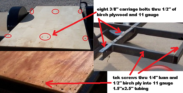

Postby working on it » Mon Dec 09, 2019 11:33 am
* I used an existing trailer and welded extra tubing onto it to extend to 8 feet. After extending work was done, the perimeter was all rectangular tubing, and two of the three interior crossmembers were C-channel (originals), while the new ones were tubing. All were at the same height, so when I added the 1/2" birch plywood 4x8 to the frame, I made a thick bead of PL adhesive along all points of contact (meaning: everywhere!), and used eight 3/8" carriage bolts thru the C-channel crossmembers to attach. PL adhesive filled the drilled holes for waterproofing.
* Then, I used TB2 adhesive to glue a 1/4" Luan 4x8 atop the birch plywood base and let it dry for a week (with weights holding it flat), and afterwards used several coats of fast-dry polyurethane (the type used for flooring) on the Luan. When it was dry, I used thirty-eight Tek screws going thru both floor sheets into the frame perimeter (again using PL adhesive in each hole). Then, I sealed it all with yet another coat of poly. Though I didn't pre-treat the base birch ply with a poly "mix" to waterproof it, the upper TB2/Luan/polyurethane sealed it from moisture quite well (I had standing water inside my trailer once, with no after effects). The underside of the trailer has been extensively undercoated with rattle-can automotive non-asphaltic spray.
