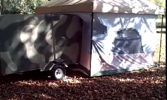

If I can't sell my little trailer then I can't really afford to get another one right now. I have found another teardrop that does not have a galley in the back and they back it up to a 10 x 10 tent that goes under a straight leg canopy. I don't mind sleeping in that tent (we already have one of them). We even have room for Jamie in there. But there are some places that we want to go that will not allow a generator if you are only in a tent and they only give the sites with electric to the people with a pull behind camper of any kind. This is even true for some of the campground areas at the race tracks that I want to take my son to.
If I make a small teardrop type camper on my small trailer and back it up to the canopy tent that we already have my fiancee and I can sleep on our air mattress in there and Jamie can be inside the camper with his ventilator and be more protected in there but we will still be all together so that I don't have to worry about not hearing him if were to stop breathing at night. This will satisfy those campgrounds that won't allow us to have electricity for my son unless we have a camper that pulls behind our vehicle and we can still all be together and the very expensive vent will be protected from the weather.
Here is a picture of what I am talking about.. http://i236.photobucket.com/albums/ff221/dstydream/1_zps087664a5.png
