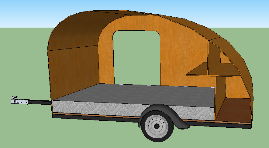

I live in the NE heights near Tramway and Menaul. It's 5'x8' plan, 4' high. Materials: 3/4" CDX for floor, 3/4" birch plywood for walls, 1/2" birch plywood (see next paragraph) for roof and hatch. I'm shooting for very light weight, about 750 # unloaded. Sketch has sidewall and tailgate removed for clarity.
I'm debating whether to (1) use all 1/2" plywood chamfered along the outline as shown, or (2) skin it with 1/8" in and out sandwiched over spars and foam. The first is easily within my skill set if I use internal cleats to join walls to roof panels and then fiberglass epoxy all outside joints. That leaves no exposed fasteners outside and I'm not dependent on glue.
What techniques have you used for roofing?
Also, I've been told to check with Stock Lumber for 5x5 birch cabinet grade plywood (will drop by there tomorrow). Any other good sources you can recommend?

Thank you to all the local tear droppers who've posted here. My plan is to build a woody, no paint or aluminum. It will be covered when not in use.
I met Capt. Bob who is quite a guy! After seeing his teardrop and talking with him I've revised my design (great thing about paper and computers it's easy to erase and start over). I now plan to build on a 5x8 Northern Tool trailer, 1/2" marine plywood floor, 1/2" birch or marine plywood walls and part of the front, 1/8" birch plywood roof and hatch over poplar spars. I will fiberglass and epoxy all exposed joints then epoxy the exterior so no outside fasteners. These are all doable with my basic woodworking skills; first project I ever built was a wood bodyboard made of plywood and surfboard epoxy when I was about 14 years old (43 years ago). Expected weight bare should be just under 600 lbs., easily towable by my Subaru Outback.
Bob convinced me to use epoxy (or to "glass" it) for exterior based on his decades of marine experience. I can get it at the local boat store (Taylor Marine) since it's commonly used in boat building. Most everything else is available down the street at Hunter-Bowen lumber. They deliver at no extra charge and carry cabinet grade. I am not going to scrimp on materials.
