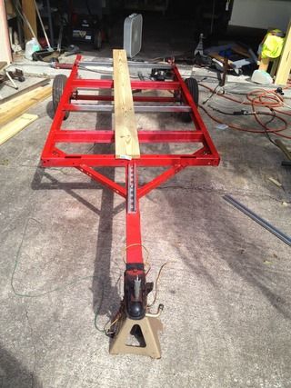

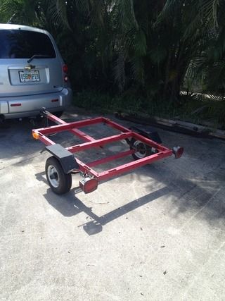

It's very easy to extend the frame on the HF 40"x48" trailer-- just make sure your bike can handle the side loads and sway from a camper.
Before- a $40 craigslist bargain
after- now almost 8ft long- to haul a small boat for local use.- a bit too long for a heavy camper. I used free bed frame steel and some electrical super strut channel for the extra cross members. You have to rotate the frame 180 to move the axle to a more balance location.
