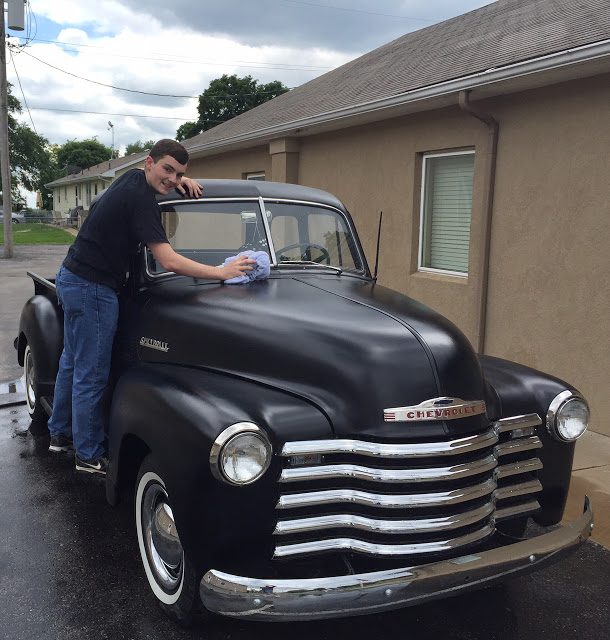

OK, so I don't think this will be doing much of the towing, but I know how people on forums love pictures.
Here's my last accomplishment with my son...... He's the backpacking one the hybrid is for.

Postby pchast » Thu Aug 10, 2017 8:53 pm
Nice truck :D
