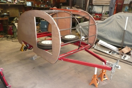

Postby Carter » Sat Jun 06, 2009 2:25 am
Steve,
What gauge tubing did you use for the tear body framework and how did you bend the stringers. Been thinking about doing the same thing.
Jim
I need a new Avatar. I'd put my dog up there but she doesn't look much like me. She's the skinny one.
Carter
Posts: 319
Images: 32
Joined: Sun Aug 10, 2008 6:45 am
Location: Rochester Hills, MI
Postby chgrsteve67 » Sun Jun 07, 2009 6:47 pm
Its 3\4 inch 16 gage square tubing.
For some of the smaller pieces I made a sqare tubing bender out of a old truck brake pad and a 6 foot piece of pipe. A propane torch to heat up the tubing makes it more plyable.
For the big pieces I used two 1\2 inch sheets of plywood screwed together, cut out to the shape of the trailier, I made a lever that could be positioned in several locations that I used to pull the heated pipe around the template. I made several ancors so after its pulled around the template I could keep the tubing in place and then spray it with water. THis hardens the steel so it keeps its shape and puts out the burning plywood.
I thought about taking pictures of the process but I figured people would laugh. :lol:
I got the floor and two inner walls cut this weekend but could not find any asphalt fence paint to seal the floor so I will have to take it all back out.
