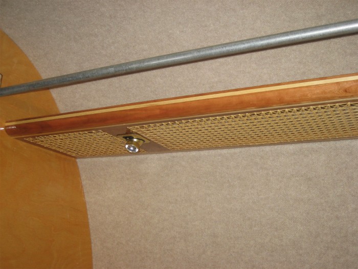

Postby Juneaudave » Sun Dec 21, 2008 5:35 pm
You could go with a luan or cheaper ply and use a glued in headliner...no problem with seams, it seems...the problem I see is getting big sheets through the doors of a closed in tear....

Postby Juneaudave » Sun Dec 21, 2008 7:25 pm
I used sand beige marine hull liner http://www.yourautotrim.com/sabemahu.html...Congratulation and I really like your trailer. I was just thinking how hard it is to fit large pieces of ply through small doors. A headliner might give you a little forgiveness in fitting and not worrying about seams...if done right!!!

Postby starleen2 » Sun Dec 21, 2008 9:36 pm
campingdude wrote: if the hull liner rough like carpet or softer?
David
Hull liner is a a little softer and and flexible than carpet
