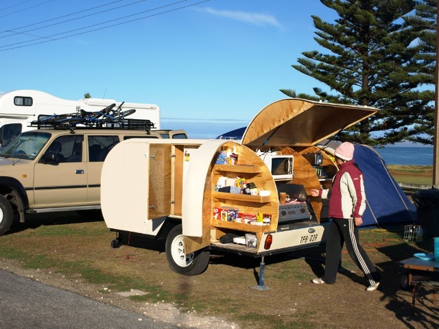

I've gone and built my own teardrop and have taken her out for her maiden voyage over the Easter break.

So I built a compromise instead. A TD with storage for all of our camping gear and a fully equiped kitchen with a couple of fridges - one for food and one for beer. The kitchen has a microwave, full sized BBQ and an espresso machine as well as plenty of storage space.
The whole build process can be seen on my facebook album here - http://www.facebook.com/album.php?aid=2003724&id=1362090661&l=b97ad5f7fa
It really has provided us the best of both worlds at a very reasonable price with some real style on the road. Including the donor van I got the whole thing together (including fridges/BBQ/etc) for under AUD$5000. Camper Trailers here start at that price for just a 6x4 trailer and topper.
Here she is on her first trip out... (the trailer, not the missus)
The BBQ slides out ALL the way, the middle section has 120L fridges on either side and the rest is storage. Of course, there are countless things I would do differently now but overall I'm fairly happy with the whole lot.

Nice looking tear. I really like the way the back opens up for storage. Very nice........

Great storage, how's it hold up in the rain? Above the left wheel, the door, is that how you get in, or more storage,

All you could ever need. Now that's a "chuck wagon" Beer fridge, espresso machine, storage and a heck of a Bar B Que.
Well Done, you should be proud, and I hope you will enjoy those great ideas being "repurposed" here in the states. I for one am taking a few things from your build.

Couple of points, now I've taken her out a bit...
1. The door over the wheel arch - that's for one of the bar fridges. One on each side. The "front" door (closest to the A frame) is access to storage. She's not a sleeper!
2. Have had a few issues with water on those hinges at the back. All I need to do is take 3mm off the side of the doors and should be fine. There is already weather seal in there but I made the doors to fit perfect BEFORE adding the seals which meant that when the seals got stuck on it pushed out the bottom.
3. I would NOT recommend the side storage doors opening at the back!
Had one catch a gust of wind and rip a hinge off. PLUS it was a LOT of mucking about with those extra curved bits and trying to get 3 curved doors to close together.
4. I DO recommend a slide out pantry instead. A set of rails like those on the BBQ are about $25 here. Much cheaper and EASIER option.
5. Not happy with the masonite roof and paint finish. Some water has got under it on the joints and warping it a little. Not sure if it is the products, tools or the builder... Would love to do an aluminium with baked finish...
The side doors came out of 'necessity'. The ply sheets are 2400mm long and the chassis was 3000mm...
