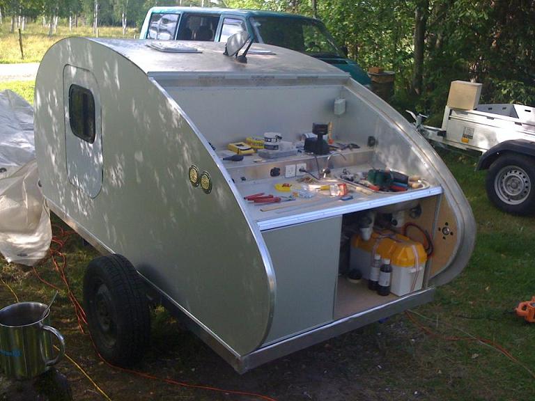

I've be working on my Cub/Modernaire since sep. last year and it's just about ready to roll out into the world.
I've been inspired by Michael Westhoff's LuxoTear and working with his plans from his website. I've made a few changes here and there...a little longer (i'm 6'5"), better and thicker insulation, complete multimedia installation etc etc.

The bottom of the TD is sealed with warm galv. steel plates. This way I could use the space in the frame for insulation and protect the frame from weather tear and wear.
After skinning the TD I placed long alu V-profiles (10x10x240cm) along the edges to completely lock out any moisture. The insulation in the floor is 60mm thick and walls are filled with 50mm so I could in theory, be camping on the North Pole without getting cold :thumbsup:
I'm currently waiting for the arrival of the aul mold/profiles I've ordered at Frank Bear/Vintek RV trailer supply, so I can finish the edges and the doors.
Since I can't find anything that resembles the fenders of the original teardrops here in Europe, I'm a little in doubt of what and where to order. Shipping costs is the greates enemy and apparently very few carriers can handle alu profiles in lenghts of 8'
