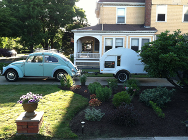

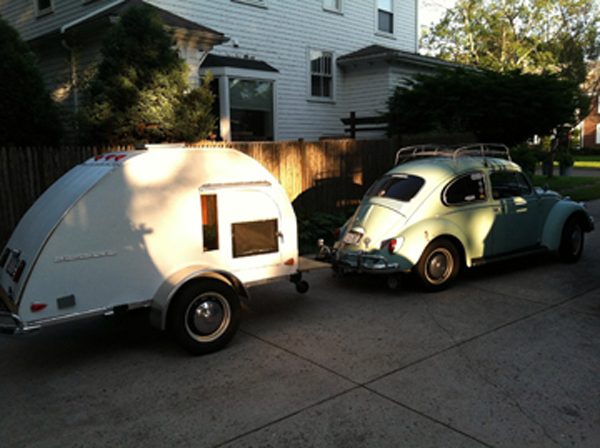

Give us a good side shot with the trailer hooked up to the bug and we might be better able to answer this question. I went into your album and tried to look and just couldn't tell from the angle at which the one side shot picture was taken.
Three things you really need to do for a good handeling combination is......
NEVER tow with the trailer nose up. Level is OK slightly nose down is better.
Axle should be placed at 60/40 of the BODY length so an 8' trailer will have the axle about 38" forward of the rear of the body. ( 96" *.4= 38.4") I have found that a 65/35 proportion is even better as long as the tongue weight is within the cars capabilities.
3rd and final as stated earlier tongue weight should be 10 to 15 percent of the total trailer weight. Measure this at normal towing height with the aid of a good set of bathroom scales.
When I first built Chubby 62 MPH was max before the side to side dance started. It wasn't bad, but it did somewhat unnerve you when you looked in the side mirror. I finally reinforced and added 18" to the overall tongue length and he is now a good boy even at 80 MPH.

Here are some pictures
The original base was 4" x 6'. Then I added an extra 2' to make it 8' long. I didn't move the axle since they are welded and I have no clue on welding.
It is definitely heavier on the galley. When I detach it from the car, its back slam down. When is empty it balance a little but still want to go nose up.
It is my first one. So, I guess is matter of weight distribution now?

Re: Jerking feeling
Postby bobhenry » Mon Jun 18, 2012 12:14 pm
Well I would say you are 3 No-No's for 3 !
Negative tongue weight
wheels centered maybe even slightly forward of center
and towing slightly nose up.
now the easy way to correct it ????
I would suggest a tongue extention coupled with a healthy tongue box to get load more forward of axle center. This is far easier than moving the axle in my opinion. To lower the attitude of pull place the coupler on top of a 2x2 ( 2 1/2 x 2 1/2) on top of the main tube then place the coupler on it this will drop the nose 2 to 2 1/2 inches.
Make absolutely sure you have that coupler locked and PINNED to keep that coupler from popping open. With negative tongue weight it WILL work open if you don't take precautions.
