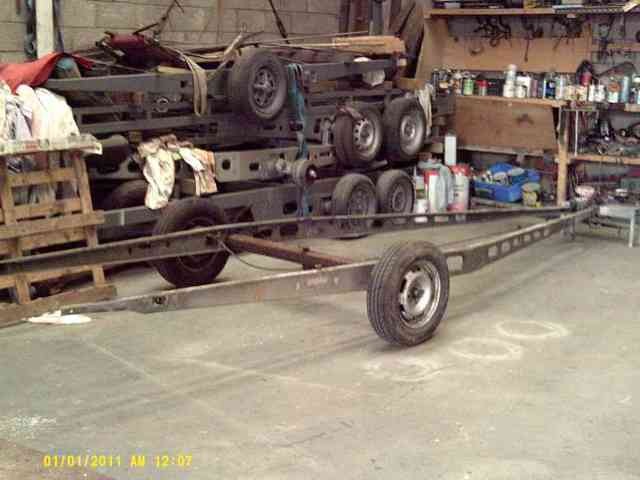

Ok so here is a photo of the chassis I'm thinking of buying its 15 ft from the jockey wheel. 9 ft to the axle and 6 behind. So what I'm thinking is leaving 3 ft tongue then chopping off 2 ft behind axle which would leave me an 8 ft bed? Sound ok?? Thanks for all the replies.

Postby S. Heisley » Wed Sep 12, 2012 8:34 pm
It may be difficult for people to offer advice on your latest ideas, Donal. It depends on what and how you are planning to build (size, weight, layout, etc.)

Postby Techguy » Wed Sep 12, 2012 9:47 pm
I wasn't going to say anything as I am not the best resource but the trailer frame there doesn't have any suspension or cross bracing. It is very different than any frame I have ever seen.

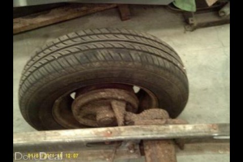

I'm planning on roughly following the plans for the generic benroy. Here is a picture of the hub with what I think is torsion suspension ?

Postby Techguy » Thu Sep 13, 2012 1:36 am
It does look like a torsion. The other photo looked to me like the wheels were on a shaft rigid in the frame.

Postby donal94 » Thu Sep 13, 2012 8:13 am
Ok the guy is going to cut down the chassis for me and I think I'll get him to weld in a crossmember at the end. I'm gettin the chassis, a small door window and a 30x30 roof light for €200. I think that's not a bad price and a good start. Thanks a lot for all of the input so far. It's a galvanised braked caravan chassis so I think it will be plenty stong for my build. What are the problems in likely to encounter due to it being 5ft wide? In going to stick with 8 ft long I think as I really like the idea of it being small.

Postby donal94 » Thu Sep 13, 2012 11:01 am
Ok so I'm just back from looking at the chassis, I should have really taken a picture of the place I will on Monday, it was absolutely crammed full of caravan parts of every description. The deal has gotten better the guy is going to cut the chassis and and weld in some crossmembers for me and also throw in so corner steadies to level it whilst parked. The chassis is an Al-Ko which is used on virtually all caravans in Europe and built in Germany, far too strong really for what I'm going to put on it but no harm as its better value than anything else I can find.
