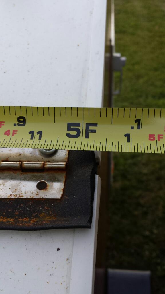

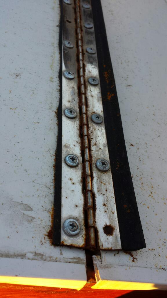

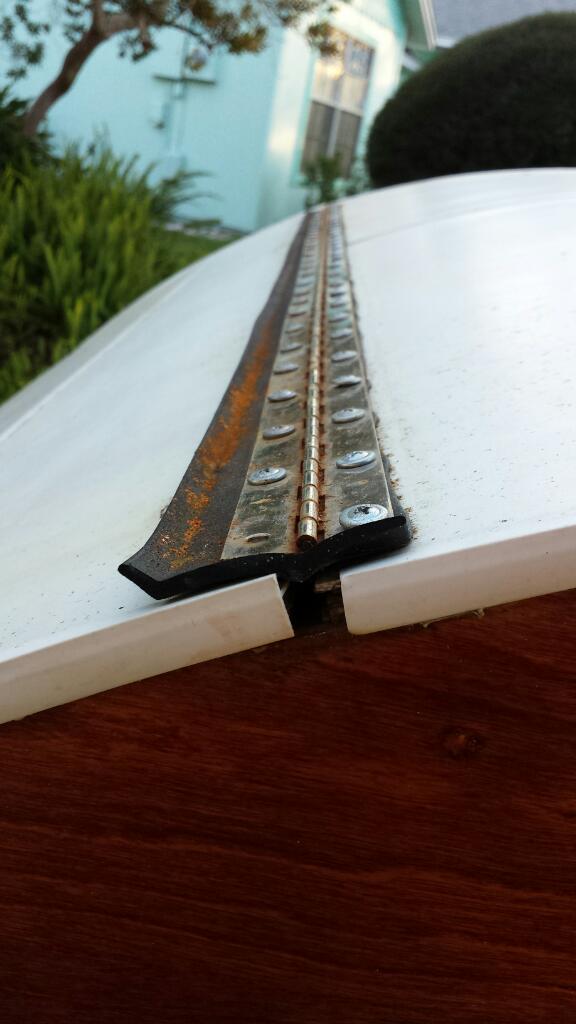

First: I'd like to replace the piano hinge and gasket with a real hurricane hinge. The owner admitted to not putting on the proper hinge and that this one leaks. But because I haven't built one yet. I'm looking for suggestions on where to start. Based on the width that I've measured it appears that a standard 5 foot hurricane hinge won't work.
